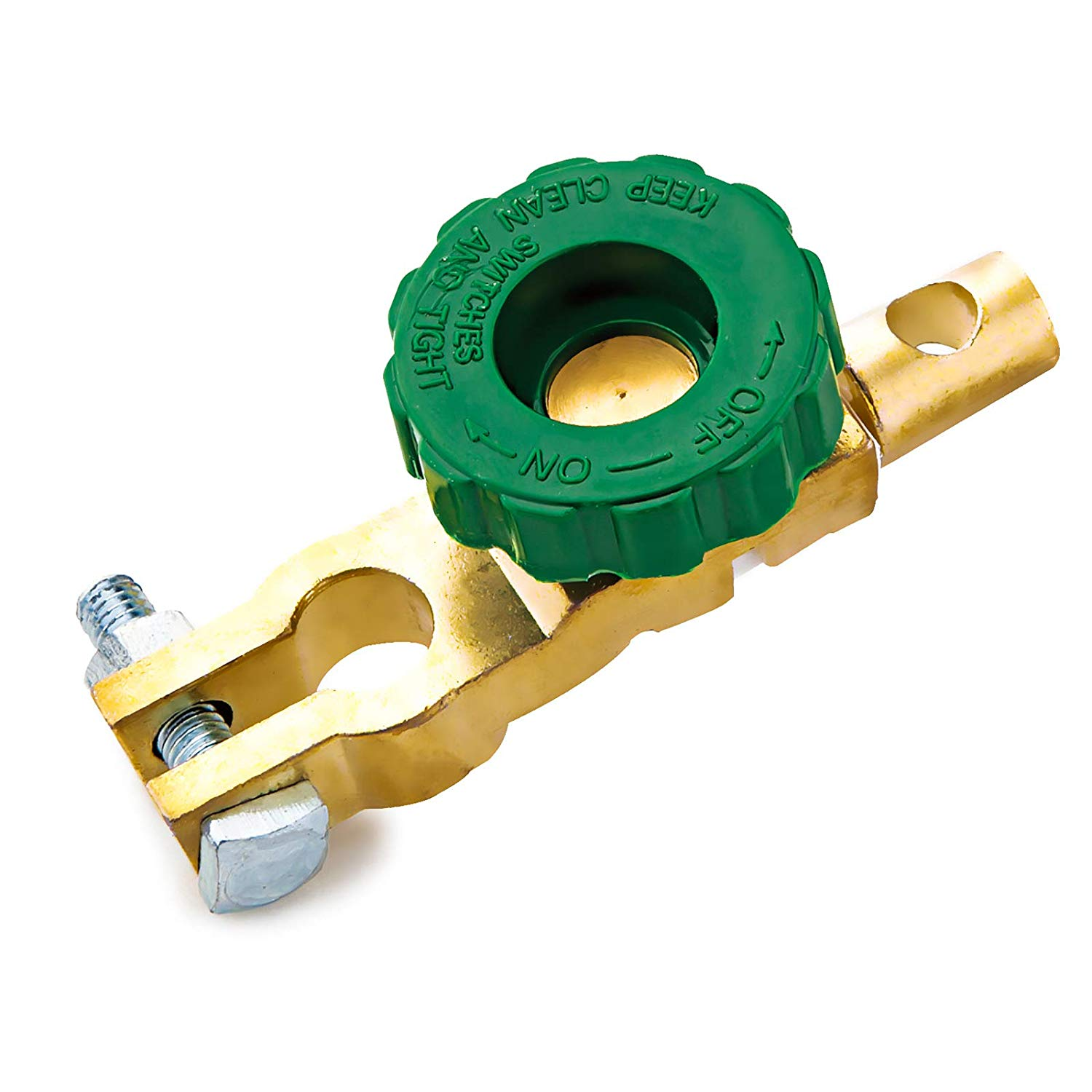

This question of spikes in voltage damaging the SKREEM has led me to wonder if placing a battery disconnect switch in the negative cable ( some are very inexpensive, less than $10) AND a rectifier/surge suppressor on the positive cable between the battery and the 200 amp fuse. For those who store their car over the winter with a battery tender on the car this may be an important consideration. You could remove the battery from the car's circuits by opening the switch before you connect a charger, but the battery remains in the car. So it is very easy. Also having the battery disconnect switch I believe would help limit voltage spikes when installing a new battery by using the switch to first open the negative cable before removing the old battery and then closing the switch only after the new battery and cable are installed. Thus no sparking when connecting the cable. What you think?
Old Dec 7, 2019 | 10:40 AM
Default Re: Battery Question
This ?? Good idea ...
Old Dec 7, 2019 | 10:46 AM
zip439's Avatar
Posts: 2,284
Likes: 472
From: SE Alabama
Yes, that is the one I was considering. The rectifiers/surge suppressors get expensive when you pay for reliability and quality.
Old Dec 7, 2019 | 11:33 AM
Tbirdtony's Avatar
Joined: Jun 2018
Posts: 134
From: Beaver, PA
I have a comment on the positive battery cable switch shown in a post above. A few years ago my friend purchased one for his 428 Cobra powered Shelby GT500. The engine would not turn over after the switch was installed. There isn't enough contact area for a car with a high current draw. I have seen these switches work on small block Mustangs but my friend could never get it to work on his GT500. It may work on the Crossfire.
Old Dec 7, 2019 | 11:45 AM
Old Dec 7, 2019 | 03:32 PM
Tbirdtony's Avatar
Joined: Jun 2018
Posts: 134
From: Beaver, PA
ala_xfire, That is the same item my friend tried on his GT500. I thought it was installed on the positive side but maybe it was installed on the negative side. From what I remember about the switches in the 1990s and early 2000s on classic Mustangs was that they were used as a security device. The owner would completely unscrew the plastic **** and keep it in his or her pocket while at a car show, cruise night, or parking lot. It may work well on a Crossfire if there is enough room for it in the battery area.
