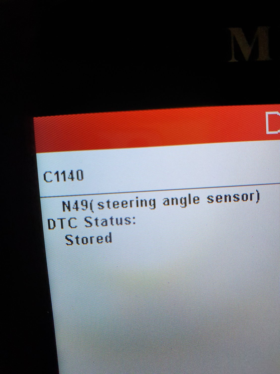

I popped my new diagnostic scanner on and I'm getting a P0410 code.
I'm also getting a couple other things that might need attention.
One seems to be an old code that was corrected.

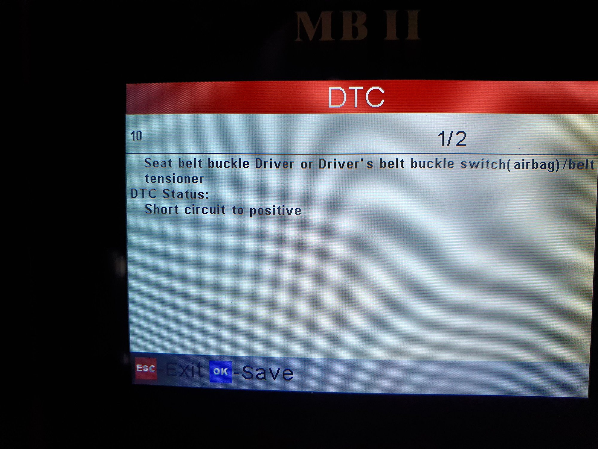

I'm guessing the seat belt tensioner fault might be there because the car was running without the seat belt being snapped in ...as if I was driving??
So... should I try to clean some connections first?
Where do I start?
