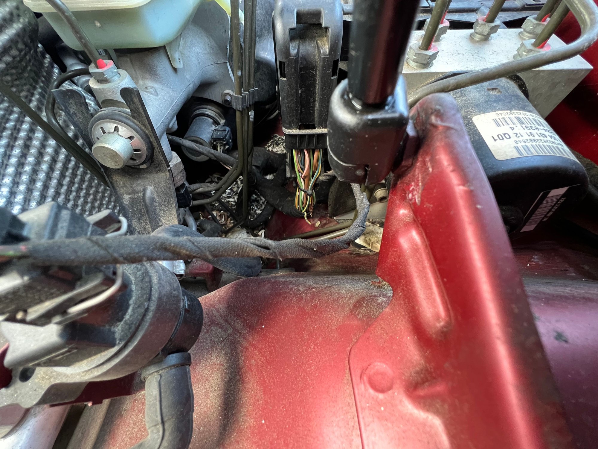

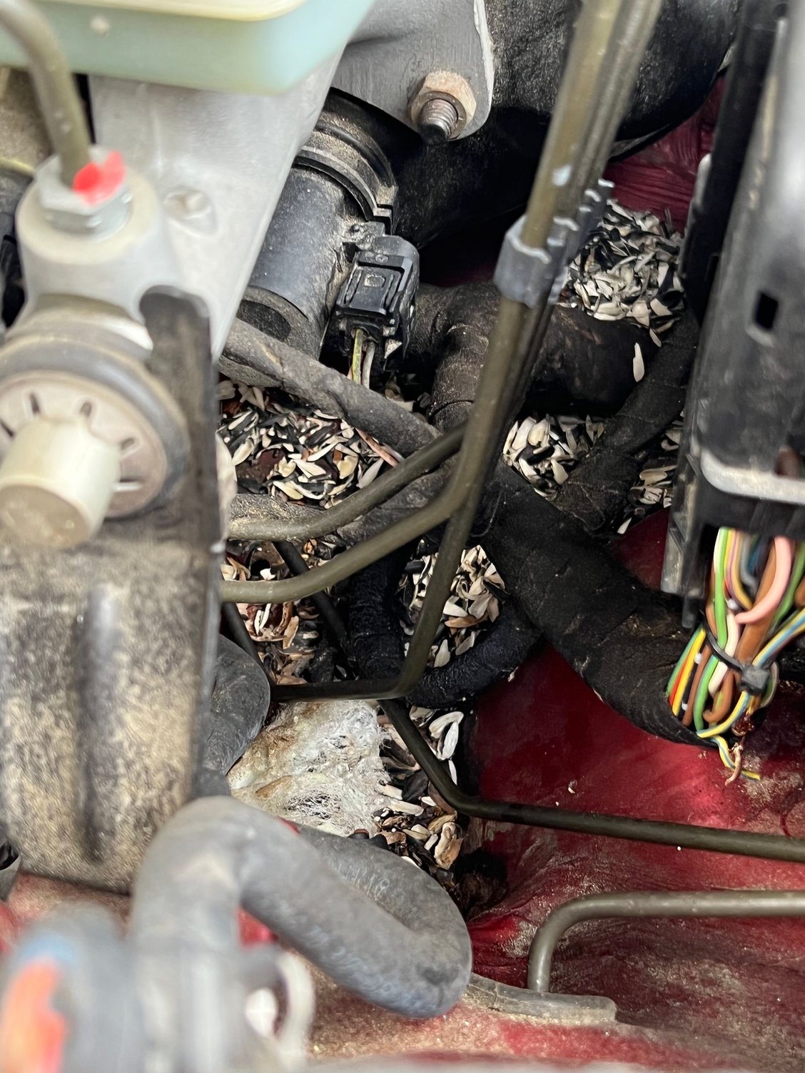

Mice ate through wires, does Anyone have a wiring diagram/description? Under hood, drivers side block of wires.
no warning lights illuminated on dash, car seems to run/drive fine..

those wires go to your CAB, Controller Anti-lock Brake. The service manual has the wire diagrams. Download it for free here:servie manual
