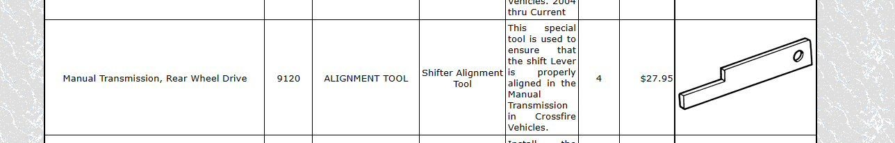

I know this is an old thread. There is a special Crossfire tool to check the shifter linkage adjustment. Just a thought. James
