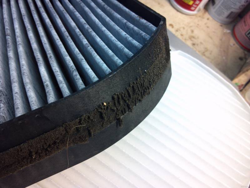

a couple months old but an excellent write up. Very detailed and exact. 5 mintes to read, 15 minutes to do work!

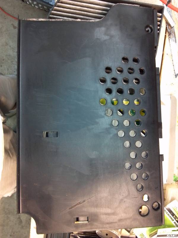

here is the old filter with the foam gasket falling apart (lucky no filter stuck to plastic housing in filter assembly)
new filter
the under dash protective cover
