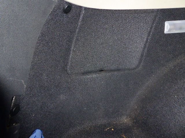

1. remove small door access to tail light blubs

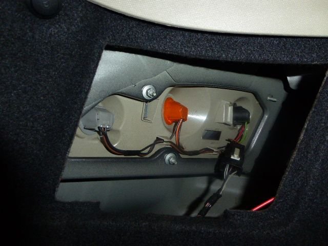

2 remove the 3 #8 nuts on the back side of the tail light
3 pull the tail light from the bottom wiggling as you pull it out.
4 disconnect the elect plug .

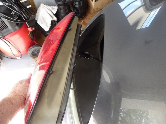

5 use knife or and little screwdriver to remove all old gasket,,
6 then clean with alcohol, also clean inside the car, where the light goes

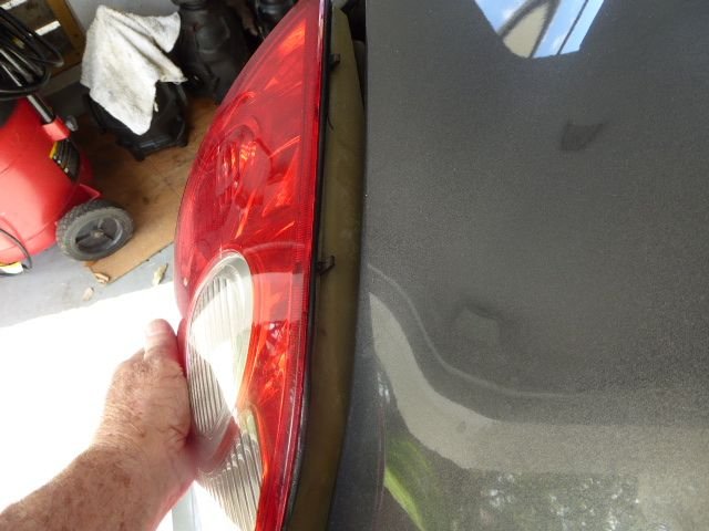

7 place gasket onto the light opening, even with the body,, about 1/2" over ,,(toolong) at each end
8 now connect the wires and reinstall you may need your little screwdriver to get the light tabshe old gasket), (tabs that held t under the gasket
on bothe ends
most likely your gasket is falling apart do not remove the gasket on the inside of the tail light
no gasket is needed or used on the bottom of the tail light,,remove the gasket on the outer edge and clean good after old gasket is removed The gasket hanging is the one u remove and clean 3/4 of the taillight

the rest of the story.
tab to get light under gasket

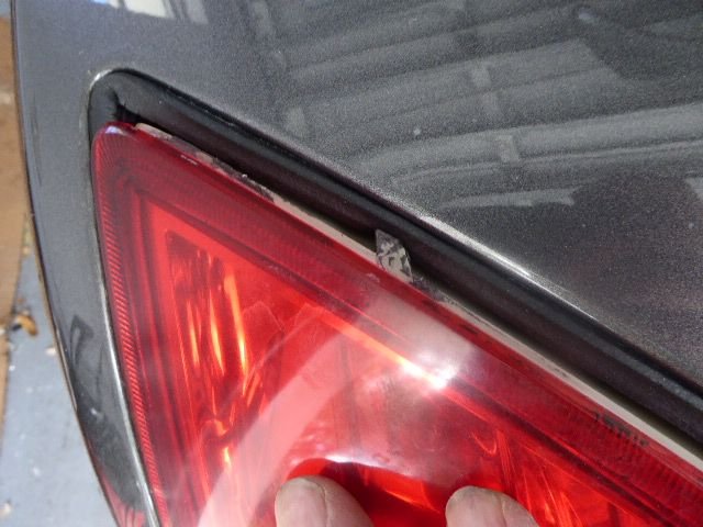

Took the time this afternoon to replace the gasket on the PS Taillight of my 2007 Coupe. Turned our fairly well with the so called 'hooks' that the OEM gasket attached to being a little difficult to get under the new gasket material. All-in-all, I'm satisfied with the result. Nice DIY from amx1397.
Might have to move the taillight assembly over a bit as I think it's too close to the body. Might cause it to crack sometime down the road.

Your welcome - Thanks for the DIY Write-up - Made the PDF simple to generate. I left out the part about removing the taillight assembly because I think it is straightforward if one follows a Service Manual and/or looks inside the trunk area. Small panel section to access the taillight is easy to remove. Dennis E.

Got nice weather today so I worked on replacing the rubber seal on the DS taillight. Total repair went fairly well & took about an hour. Checked out the taillight function after putting the light assembly back in place. Everything works like before. I'll post pictures tomorrow.
