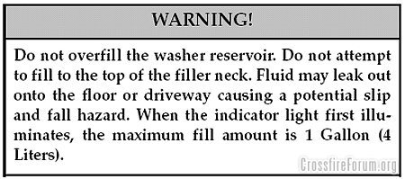

I DO have washer fluid designed for very low temps in my XFire, but with temps in the teens, it seems to me to be freezing up. Works in the morning when I leave, then quits later in the day, like it's empty, but then works again when it warms up.
Old Dec 19, 2010 | 04:25 PM
Posts: 10,458
Likes: 156
Default Re: Washer bottle woes...
If you fill it to the top, it will leak out from the fender behind the wheel. Once the dash light comes on, only add 1 GALLON. Anymore than that and it will leak, normal.
