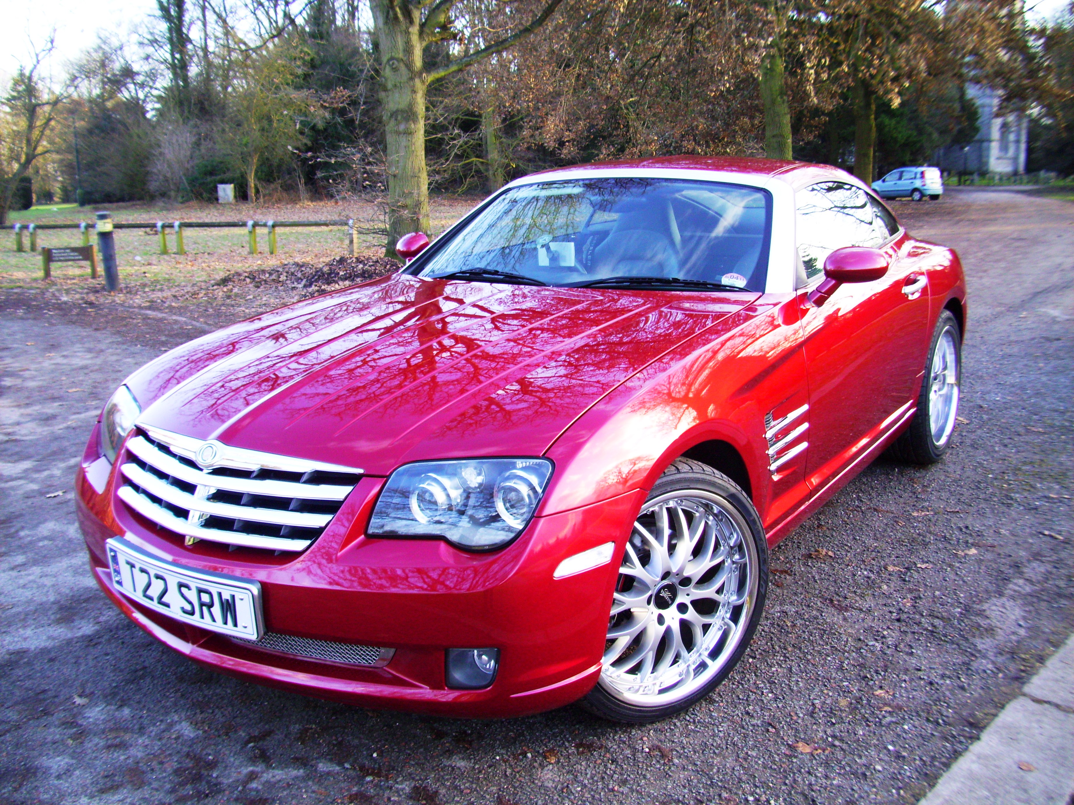

These are the experts for both wheels and tyres. They supplied mine and were very careful to make sure the wheels suited the car properly. A wheel change can be done easily but great care is needed to get it right so the car rides, steers and handles properly. I spent some time on this as I wanted 19" all round without the risk of rubbing. My rims are an inch wider than standard.
Front 19"x 8.5" rims offset 35mm with 235x35x19" tyres.
Rear 19"x 9.5" rims offset 22mm with 275x35x19" tyres.
R Tec have pics and a record of my fitting for future reference, and I would speak to them.
Good luck,
Steve
See UK Crossfires - For owners of the Chrysler Crossfire in the UK, email us via the site contact page to get on to our mailing list.
