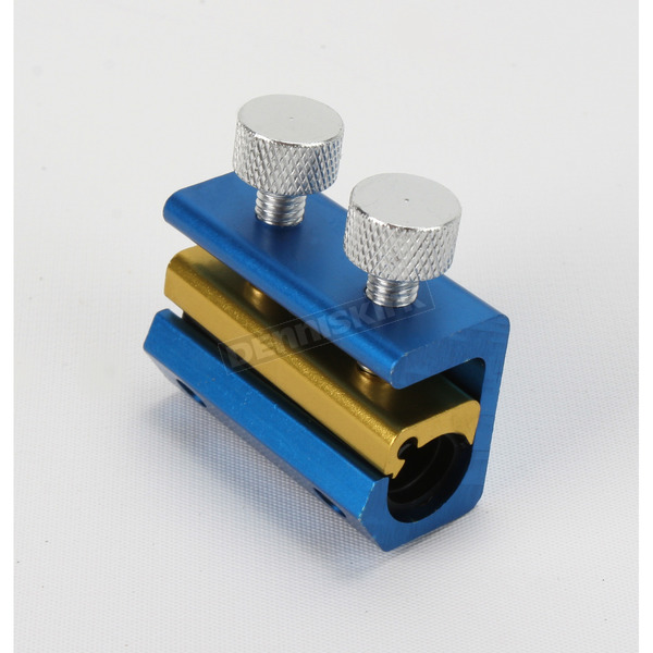

Hey Bob, have you tried that motorcycle cable luber I posted about years back ?
Worked for me
Carb cleaner first, then compressed air, then teflon lube.
PS: It's kinda messy.
Worked for me
Hi Dr. George, I just ordered that cable luber piece. I will lube up all my cables as soon as I get it. Thanks for refreshing my memory about that . . .
