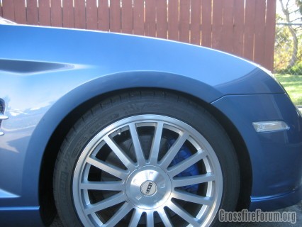

Just kidding, I actually lowered it with Eibach Springs and just got it back. The springs havent setteled yet, so the front is raised by about 1 inch above stock height^^.
Anybody else experience that after install? How long did it take till the car finally dropped down to where it should?
Attached is a picture of the front being higher than usual...

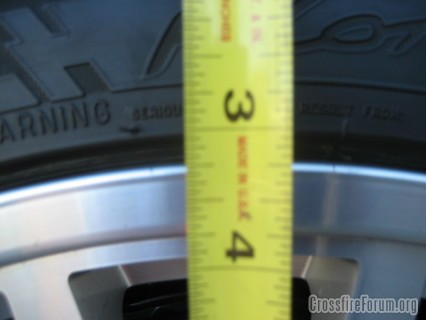

Here are the pictures.
I mean, something must be wrong. If I had dot 5's in the front before and dot 5's in the front now with Eibach springs, the front should sit lower. Right? Can someone please check my logic
The rear came down, but the front dident. But can the front raise that high only due to the spring pads? I guess I'll crawl underneath there and see if I see something that shouldent be....
Pictures from left to right:
Rear stock, Rear Lowered, Front Stock, Front lowered

The distance from rim to the panel in the front is 5 inches. Just an exact number to be more specific
Thanks for all the help so far! I really appreciate it.......

I just came back from underneath the front. The spring is seated correctly in the spring pad. I wasent able to get a good picture of it, but I saw it.
Otherwise everythign else looks fine.
Attached are 2 pictures from the front. Does anyone see anything that shouldent be the way it is?
I think its just the spring pad. I guess I have to get new ones and install them.
What would recon. which spring pads should I use, dot 2 or 3 for the front to get it to an non-rubbing low?

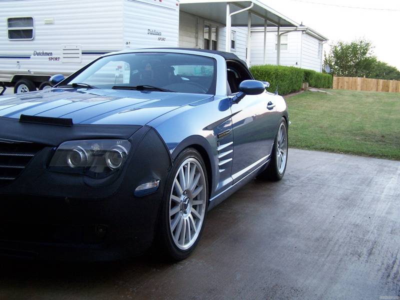

Old Aug 26, 2010 | 07:24 PM
MikeR's Avatar
Posts: 5,180
From: North Plains, OR
Default Re: I lifted my XF!
I have 3 dot on the front of the Aero (factory spacers) and 1 dot in back... see pic in my signature
you should not need to do a realignment...
