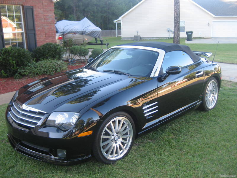

Question..... Are you happy with the stance/profile with the way the wheels look now? In other words, when you look at the car from a side profile, do the front or back wheels look like they are inset into the fender wells too far?
Here are a couple pics to illustrate this: Sorry for the crappy quality of the pics
No spacers:
10MM spacers on front and 15MM spacers on back. No rings required as they are stock rims.
Notice how the spacers allow the wheels to provide a more streamlined look from the side profile? I hope this makes sense. I know it can be a bit confusing.

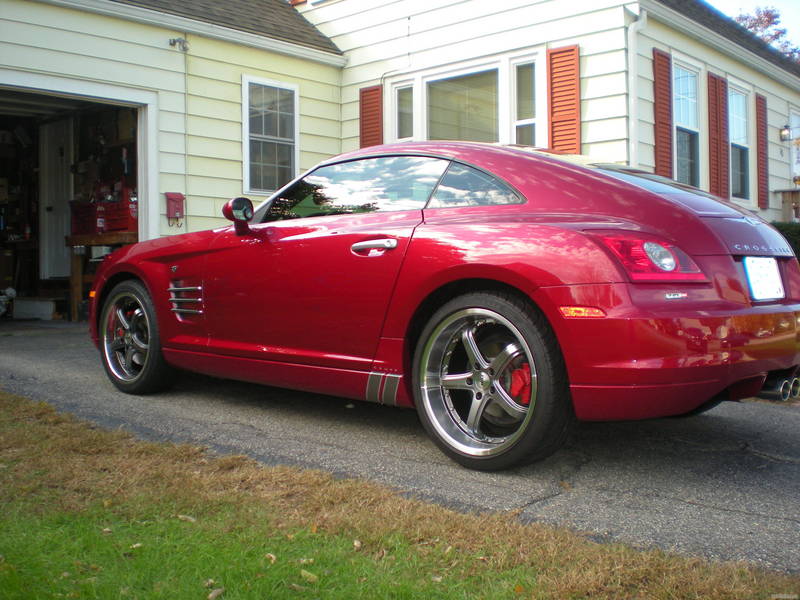

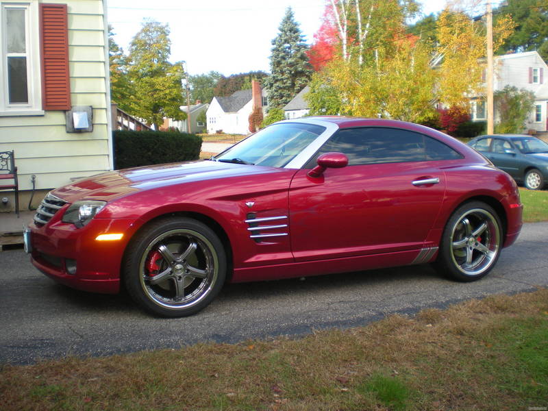

green-ghost's Avatar
Posts: 1,495
From: Somersworth, NH
Default Re: new rims and bad balance?
Yes, it makes sense, seems the rings will resolve the issues. I do like the way the wheels sit on the car. Heres some pics
rear wheel spacer...
front wheel no spacer...
Old Oct 17, 2010 | 10:04 AM
bmorgan's Avatar
Posts: 3,459
From: Warner Robins, GA
Those are some small spacers on the back. Probably 5MM. It must have had a clearance issue. Is that a gun metal finish on the wheels? They look very nice. I noticed how the wheel finish really coordinates well with your slasher stripes. Very nice.

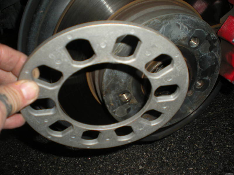

Old Oct 17, 2010 | 05:21 PM
Posts: 1,495
First of all, THANKS for all the help guys! Just brings testiment to how I brag to others of the level of cooperation this forum has for each other.
OK, just pulled rear wheel off and the center bore of the rim is indeed 74mm. here's a pic of the 5mm wide spacer they put on thats just floating in place by the lugnuts. I can see the problem now.
here's how it looks inside the rim
Old Oct 17, 2010 | 08:18 PM
bmorgan's Avatar
Posts: 3,459
Yep, those would definitely be a problem. Loose those quick.
