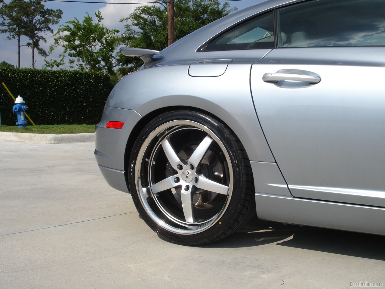

IMAG0125.jpg one of my srt6's with a 19x9.5 rear with 32mm offset on 295 30 19 tires!!!!!! front is a 19x9 with a 34 mm offset! as you can see a PERFECT FIT!
The iforged wheels are wrapped in 305 30 19 michelins!!!

perfect fit? I beleive the engineers had a closer perfect fit with a 22mm in the rear. and I think it looks even better with a 12mm spacer like Andrews...
that equates to a 10mm offset in the rear! (et 22mm - 12mm spacer = et10mm)
Your wheels definitely do not look bad, but that fat *** tire in the back is definitely helping to compensate! also, isnt your rear tire a 305 30 19 in that picture?

Do what you feel is right!! and I'll do what I have been doing for many years. We will leave it at that! Fair enough?
as you can clearly see in my picture the rear tire does not play a significant roll in width to the outside! the tires is still with in the bead of the wheel! as if weren't the tire would not mount! So obviously that does not play a major roll to the outside of the wheel and tire height! If you know what that means!!!!! those are 295 30 19 inch tires as stated before!!!! would you like a close up>?
I have run 305 30 19 and they have been mounted on my Iforged wheels!
you still haven't proven any points in this conversation nor will you ever as I know what I'm running and I know what my crossfire can and can't run!!!!

32mm OFFEST REAR
and 34mm OFFSET FRONT
SITS PERFECT~
NUFF SAID! I DON'T THINK YOU CAN HAVE A SRT6 SIT ANYMORE PERFECT!
and if you think those are the 4 best looking wheels on a crossfire than as stated before keep doing what it is your doing and Ill keep what im doing! MOVE ON KID! NEXT SUBJECT GROW UP, YOU HAVE STILL PROVEN NOTHING OUTSIDE OF BAD TASTE! If you want to start a flame war take it to PM's

Here are the wheels! Next on the decision making is how to get the car vip style low.

32mm OFFEST REAR
SITS PERFECT~
NUFF SAID!

Because I have a 22 offset OEM on the rear, and 34 would not sit perfectly....

the 34mm sits perfectly cause of the wider wheels. 22 for the factory 9" wide is great but as you widen the wheels you need to "pull" the wheel in to keep the extra 1/2-1" in line
