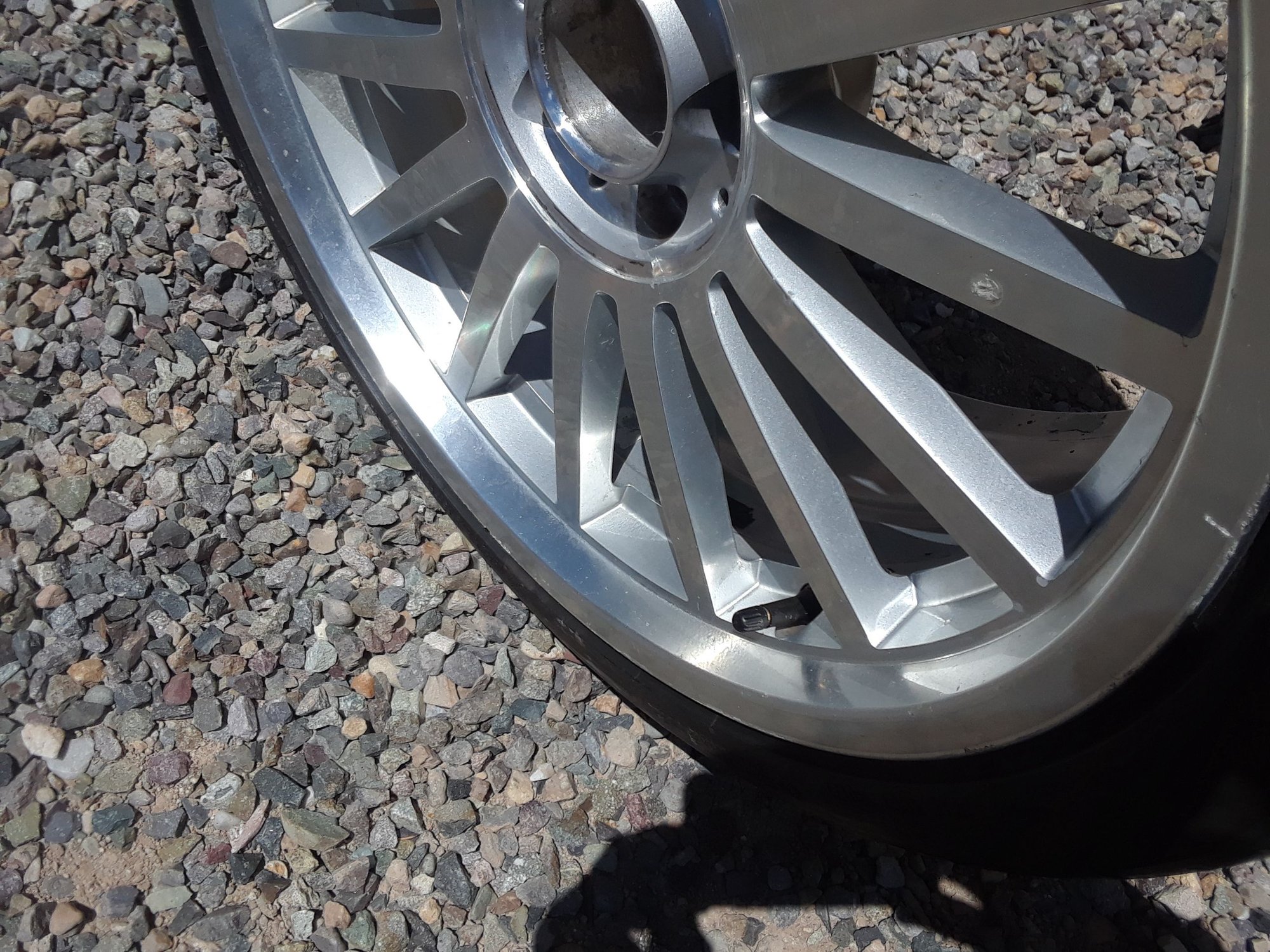

I recently acquired a complete set of SRT wheels that are factory painted, I assume off a later model Limited . Yes they are srt wheels, all the factory numbers match. I am trying to figure out the paint color for the outside of the wheels, The face of the spokes and rim are painted " chrome" with the rest of the inner sides of the spokes and the back of the wheel painted the normal silver grey, the " chrome" color is the one I need as I need to touch up the usual curb rash. I can find only limited info on these wheels and I know someone out there has more info than I can find. Thanks for any help. I am not able to upload any pics right now for some reason

How about some pictures, easier than going by your description, since no SRT wheel came from the factory with Chrome segments.

A Picture is worth a thousand or so words vs. assumptions....

Those are standard 2005/2006 standard factory wheels. The wheel lips are "machined as well as the outer face of the spokes and the remainder of the wheel is painted the same silver wheel paint as on the 7 spoke Limited wheels. The SRT6 wheels are rashed, but can be refinished by a competent wheel rehab center. They will also confirm the trueness of each wheel. Your looking at $100-$150 per wheel to correct the defects and repaint the wheels. Those valve stems are not the original ones, TPMS sensors removed?

the reason for the question, is that all of the wheel is painted and then clear coated. The outer face of the spokes and the outside edge of the rim is just painted a different color like " aluminum " or the such. I know this because I sanded through it to see about doing a little rash repair. I just can't figure what the outer face color is and do not want to refinish every inch of every wheel unless I have too. I have an 05 limited with 7 spoke wheels and believe that the silver color is the same on both, except the outside face is different on the 15 spoke version, which is the exact same part numbers as the SRT 6 wheel. I have owned both and this is a little different animal

The wheel looks like the one used on 07 Anniversary Conv. model. The second one I have seen,
The cars were painted a dark Red or Maroon. The wheels look like the ones in your picture.
The cars had dark Grey or Black interior. Small seats made of cloth. Not the high back ones .
Miller Brothers Auto in Mill Hall,Pa. has one for sale in there show room right now. I have one wheel
in need of repair. I went to one of those sand blasting shops that said they have to do all wheels
and they would NOT match the OEM look. I said no thanks.

The wheels pictured are SRT-6 wheels which were painted silver between the machine finished spokes. SE Roadster wheels (which are the same as SRT-6 wheels) were painted a much darker argent color between the machine finished spokes.
The SE Roadster was model year 2006-2007 only I believe.
I'm pretty sure XFireMike is referring to the SE Roadster (though calling it 07 Anniversary Conv. model) and they were painted Blaze Red Crystal Pearlcoat only.
2 very good image references below.
