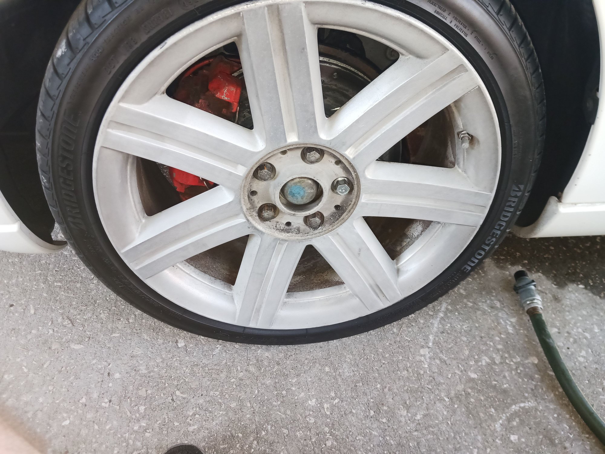

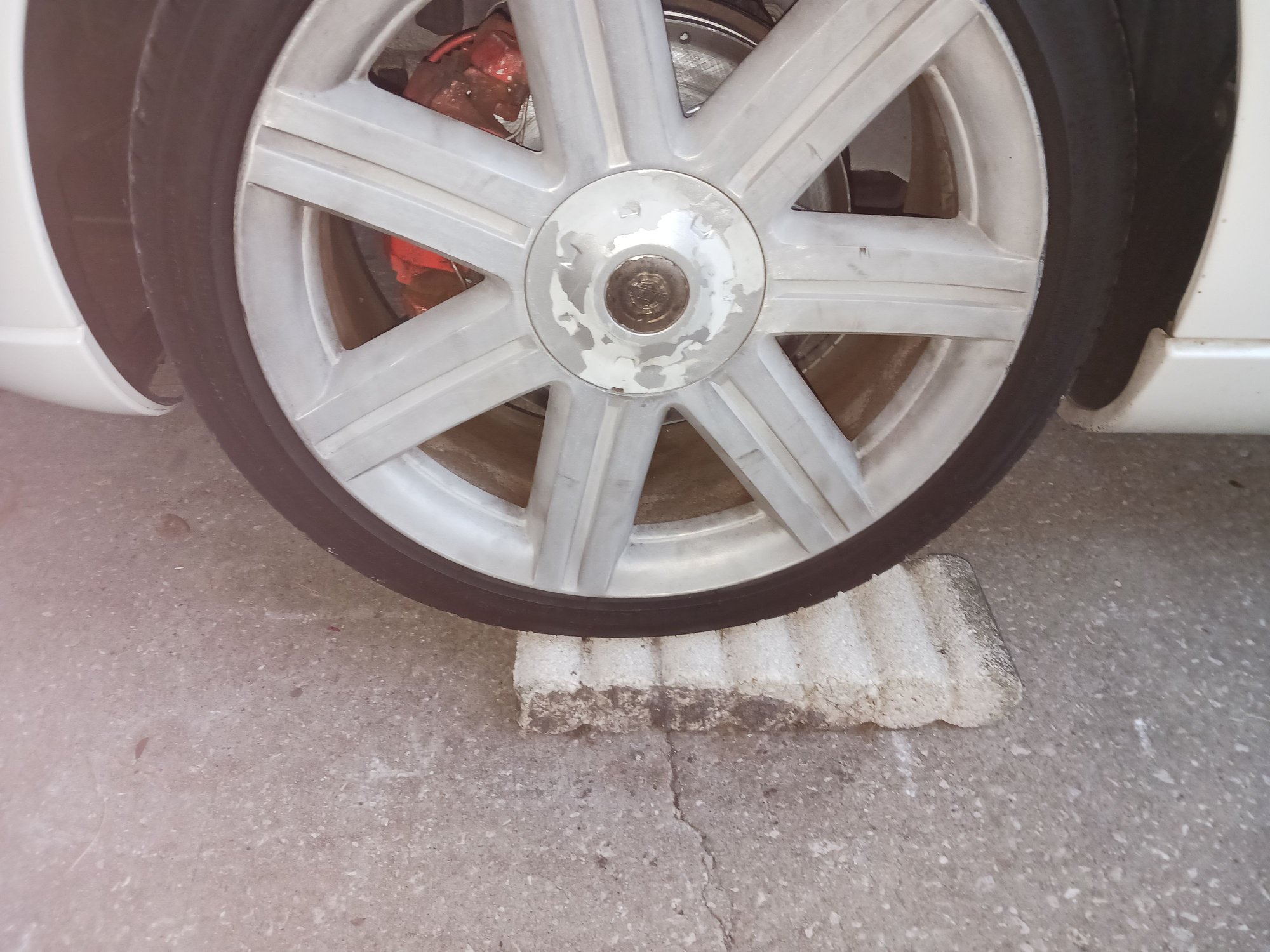

I just got the "WOW" factor on my 22 year old rims! I watched YouBoob about cleaning aluminum rims and really impressed with Purple Power Aluminum Brightner. "NOT THE PURPLE POWER DEGREASER CLEANER PRODUCT." So off to O'Riley's Auto and bought it for $18 for a gallon. Very easy and very fast to use! Only used about 16oz to do all four rims "twice!" Going to investigate sealing the cleaned aluminum. I don't think I'll be worrying about rim painting or replacement for a while. Before and after pics below. They actually look better than the pics show!

Hi Romad, It looks someone stripped the original finish off your rims back to bare aluminium and then painted them white. A non-professional job and as such the white has come off most of the wheel. Thereby leaving the bare aluminium exposed.
I would recommend cleaning and prepping the wheels completely, priming them and repainting in 2 pack as per zip439's post above.
