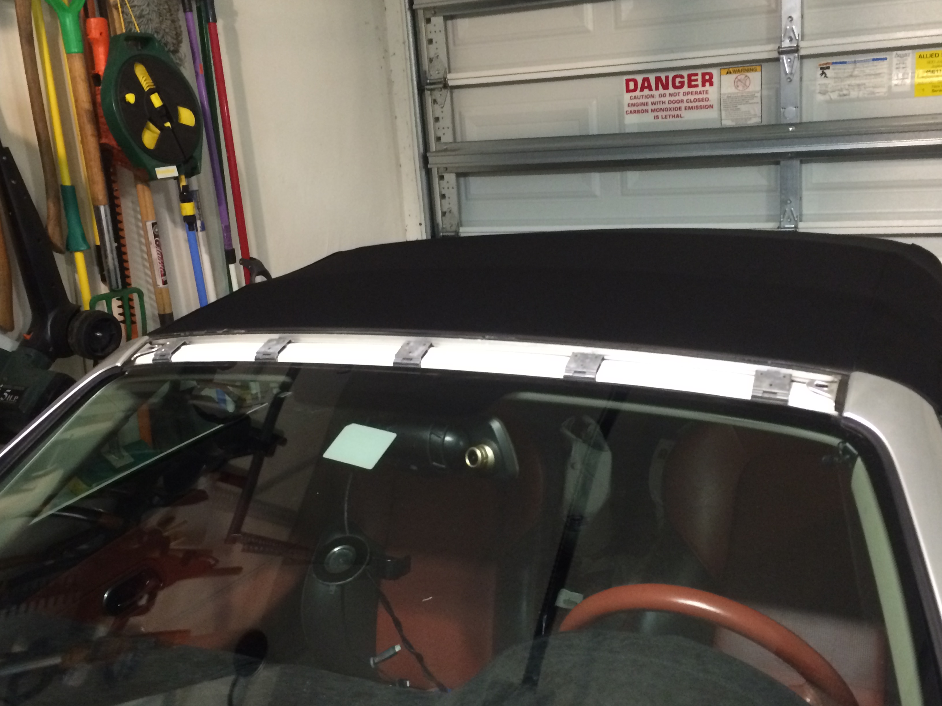

Appreciate any assist to locate replacement trim for windshield crossbar. Apparently blew off in high speed windstorm ( ).
Want to avoid OEM replacement - $400+
Thanks in advance for ant assist.

There is a national Salvage yard, one located in Florida, that may have the part you are looking for at this time. Google LKQ.com and contact their Florida location, I've seen their inventory in the past and it contained numerous Crossfire parts. When buying this part, make sure its off a Roadster (original part# ends in 187) since there is a difference with the coupe (ending in 107). The coupe model has a strip of rubber at the top of the part that rests against the metal roof, where the roadster does not need it, since it rests against the existing rubber.
Their system should find one within their national branch search.
Good Luck....

Learn something new every day....I had to walk out and visually verify this on the cars! Lucky for roadster owners since the rubber strip can be removed. I have a spare one, contact me.
