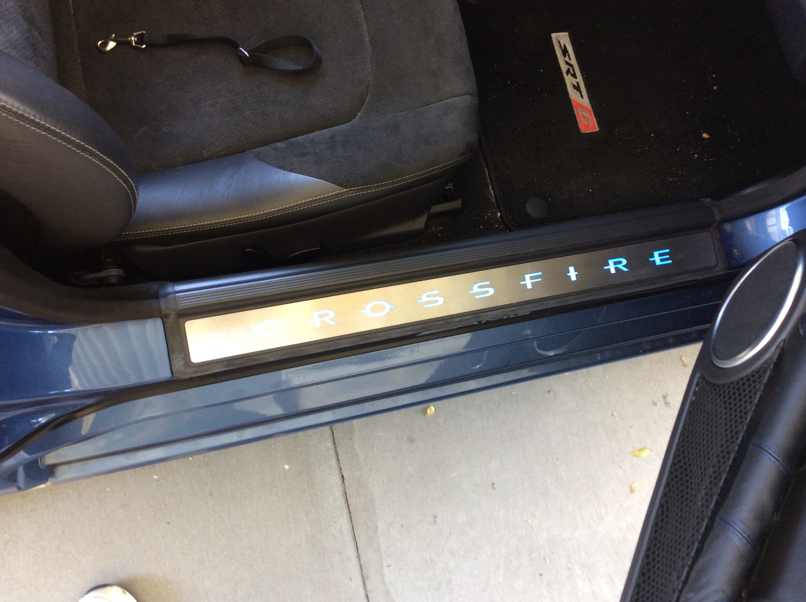

Why do you need only one. They are relampable (if that is a word)
I did mine in blue

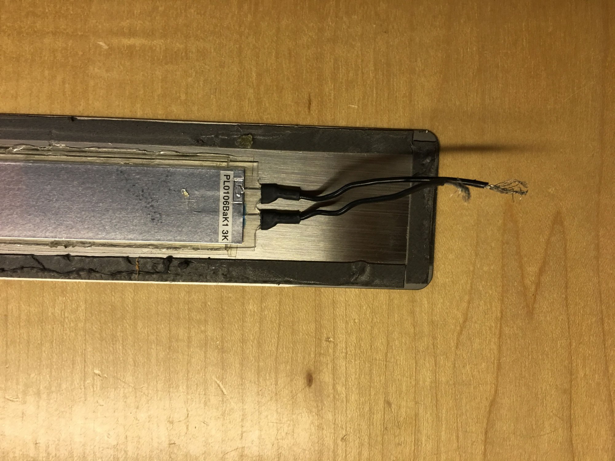

Your message is extremely well timed. I've just disassembled the sill that wouldn't light up
I've been looking on line (eBay too) for a replacement LED STRIP. There is no shortage of choices.
I know I'll need one that is approx 24" (60cm)
What I don't know is
1) best available brand
2) can the original light strip be sourced
3) does the replacement wire in any differently or can I hook it into the existing relay/ transformer
4) if I have to replace the stop/ ribbon, what is applied over the clear plastic to make it opaque
Installed them a few months ago. New OEM right out of the box. Two weeks after install, one just stopped lighting up (crap)
When you re-lamped did you do both or were you able to just do one. Any suggestions would be welcome and much appreciated.

Have you narrowed the problem down to just the LED strip for certain ?
Can you substitute just the LED section for the other side of the car, or connect to the wires for the other side ?
The actual LED bulbs themselves almost never "burn out". When you see LED bulbs out, like in traffic signals, that's because of bad soldering, that's why entire strips go out.
Maybe you can make sure it's not some other part there, or the wiring connections. Did you follow the instruction sheet that came with the kit ? A PDF version of it is available if you did not have instructions. I see on the PDF, there is some sort of assembly you mount behind the seat, I assume some sort of voltage converter. I know you said it worked at first, maybe part of that stopped working.
I think if you can hook the sill up to where the opposite side of the car is connected, you can confirm it really is the LED strip itself or not. Then maybe the strip could be repaired if it is not all sealed in plastic.
Just trying to help troubleshoot.
Is the strip actually LEDs or is it an Electroluminescent strip ? Does it have discreet bulbs that make the panel strip light, or does it seem the entire strip lights up itself.
Now that I think about it some more, I'm guessing it is electroluminescent.
If it's not LEDs, an Electroluminescent replacement strip should not be expensive, here's an example strip I found, there's a lot of them available in different colors at various sellers.
https://www.adafruit.com/product/415...FQEHaQod0ToL-g
Maybe the unit you mount behind the seats is an inverter for electroluminescent strips, and that's how this was made.
That same site also sells inverters powered off 12V DC so if that is what you have, and that is what went bad, and the strip is still good, you could try a new inverter.
https://www.adafruit.com/product/448
Or start from scratch, using the stuff they sell and change to electroluminescent strips in a color that matches your new preference.

This thread named "Illuminated Sill Plates - Color change revisited" confirms that the strips are electroluminescent.
I would think it would be unusual for this kind of strip to "burn out" in just two weeks. So the same still applies to the thoughts in the previous post I made.
There's an entire procedure on replacing the strip with a different color. They also replaced the inverter with new ones, but you may not need to do that unless yours went bad.
Maybe the wiring somewhere is not making a good connection, or the inverter has gone bad. You might be lucky enough that buying a new inverter will correctly power the existing strips. Maybe the inverter happens to have a label telling the output current/voltage, and you can confirm a replacement would also be in the same range. Again, if the other door is working, you should be able to narrow down for sure what part or wiring connection has failed.
Also, the 60 CM written on your picture is for 60 centimeters, which is almost exactly 24 inches. So it looks like 1 inch by 24 inches of electroluminescent tape is what you would need.
I used 24x1 wish I could have gone to 24 x 1 1/8 or 1/4
I'll send you a pic of the one i bought by email others I'm sure would work
Looked for a long time and I would say no. Relanping lets you change the color
they are I think power inverters and I used one on each strip (sill)
I wanted to route 12 volts both sides for footwell lights in the same color
I left mine blue to match the car.
Age kills those old strips. New ones are better
Did both because unlike the oem. The electroluminecent strip is colored and oem is clear/silver
Email is roglemof46@gmail.com

The problem has been narrowed down to the light strip
The existing power inverter is working fine for both sides
Immediately upon one of them failing, I swapped the sill locations and the defective one was still defective
Until I opened it up, I had assumed LED strip, I was not aware that there was an eluminecent strip and associated Power inverter as indicated in both responses. I've clicked on the links. We're on the right track.
The reference to 60cm is mine. When you reside in Canada, Metric comes naturally and all eBay Light dimensions are also posted in mm or cm.
With luck, Roger will have a few photos for me this week and a specific brand that was successful with his swap

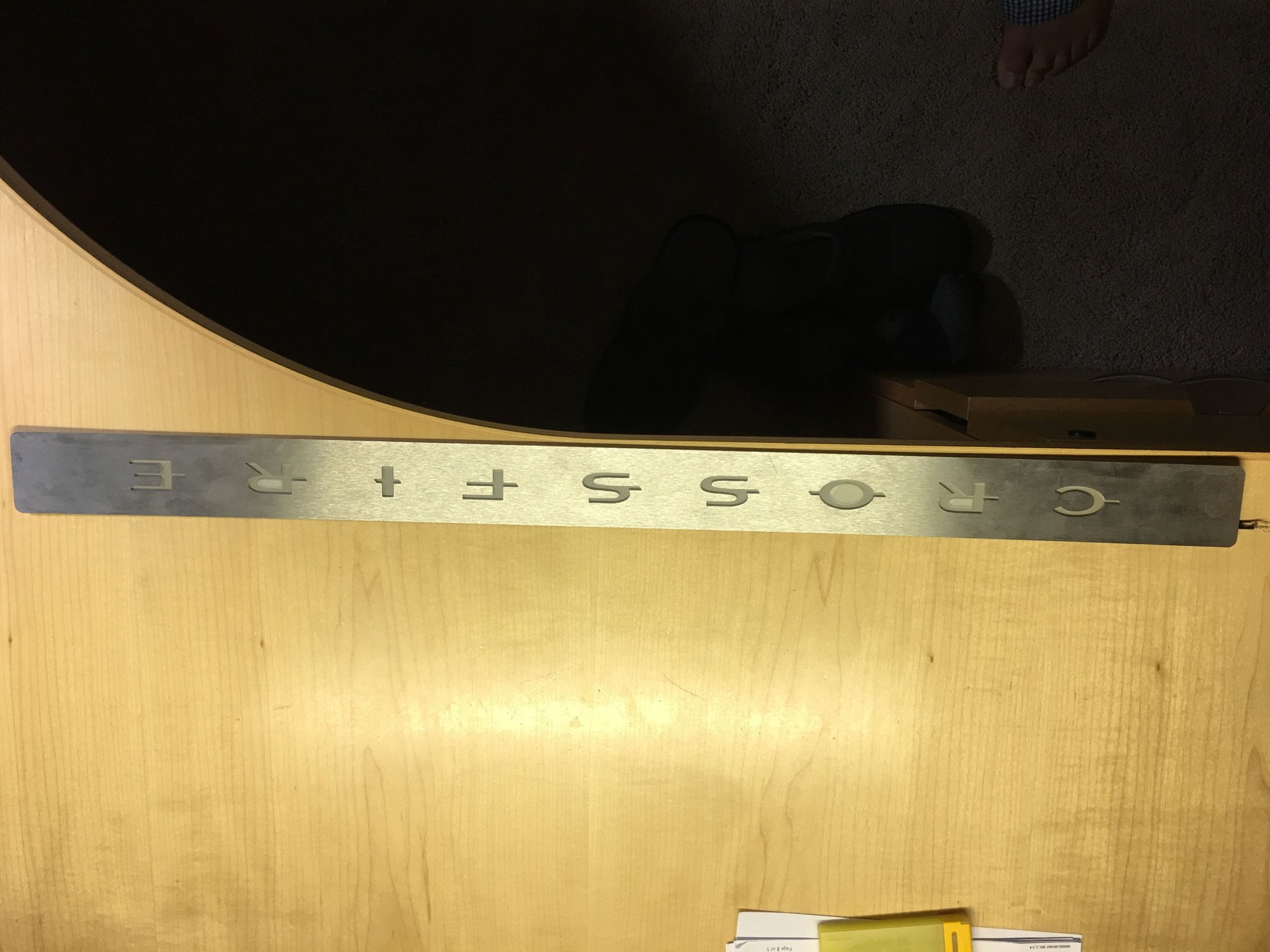

I saw a you tube video on how to Mach illuminated Sill plates for a Mustang
If I get time this winter I may attempt to fabricate a pair with my original non illuminated plates

with the expert assistance I've received, I've ordered the parts required to repair them
you tube also has quite a few videos on how to make them. Going to try that this winter on my original sills

Project complete
Roger,
Thanks for directing me to the luminescent light strip
The repair took a few hours but was really simple. Lots of prep work
