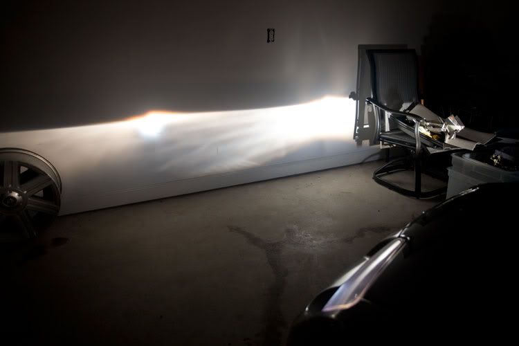

Well apparently my passenger side headlight is brighter than my drivers side and I can't seem to figure out why. I'm pretty sure they where both the same at one point... noticed it pulling into the garage tonight.
Anyone have any ideas?
Passengers is brighter
Drivers side
Passengers side - it appears to produce more light further down as well.

Had a similar issue and the bulb on my passenger side was just not exactly in place. It was making my driver side look really bright only because it was not projecting as straight as it should have been. If you look close at the headlight there is a little dark shadow right below the light (in your picture you can see it on the passenger side, little dark dot towards the grill). I do not see it on the driver side picture, when both bulbs were in correctly the dot was in the same spot on both sides (mirror style). Might want to pull the driver side out and pop it back in, might end up looking like the passenger side.
Airscape you nailed this one!! The drivers bulb was actually loose... I mean as in broken away from the metal surround the clip holds down. I'll post a pic up soon as I just got in after 2.5hrs of work. Had to remove the whole headlight assembly to get the bits that broke off inside.

Here's just a pic of the bulb...
Thanks again guys! They're now both evenly bright!
