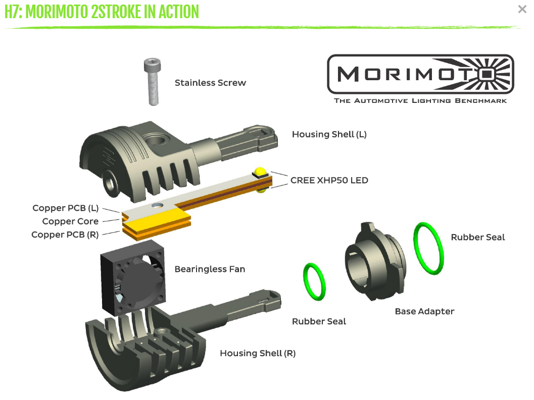

TRS ( The Retrofit Source in Atlanta ) has a new offering, the H7 Morimoto LED bulbs. They say you can even get a 'cap extender' to keep the units sealed, I have an inquiry into them asking if they have actually installed in a Crossfire. The cost is reasonable at $135. They also have the 9006 ones for the fogs at the same price per pair.
These bulbs have a horizontal no-bearing fan for cooling.
I'll report back what they say.

Ah they do an internal fan! Makes sense then. Otherwise I was worried about cooling. The OPT7's fans are NOT quiet! Can hear them over my actual radiator fan on the Exige lol
