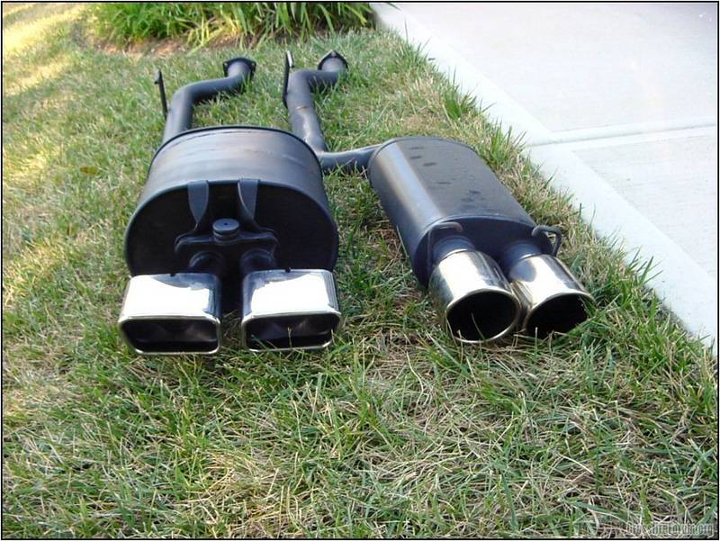

Here is what my Borla/Mopar Performance exhaust system looked like:
Old Sep 17, 2013 | 08:31 AM
Posts: 10,458
Likes: 157
Default Re: Borla Rear Muffler Mount
Hard to see here. If you have a universal muffler, as shown on the right, you may consider taking it to a muffler shop and have them fabricate hangers.
