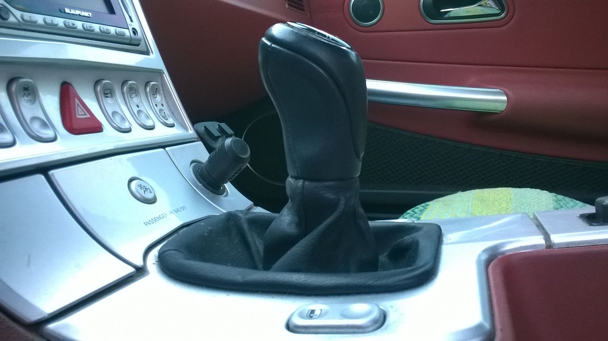

The **** has a nut on the back side of it hidden under the boot, it is just unscrewed and you pull the **** of the shift lever.
You gently pry the boot of by getting under its frame as shown in the photo.

All of the SLK shifters will fit Crossfires. Mine is a Manual and I have the SLK 6-speed shifter.
