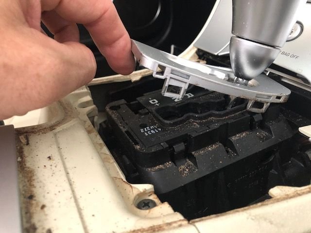

Since I wasn't able to find any information on how this came apart I thought I would take some photos along the way.
Note.....I just bought this car and it was filthy as you will see. Lifting these panels reveled even more debris. Clean now though!
Anyway...I started by gently working a putty knife around the plastic trim piece around the shifter ****.
Then I was able to lift up the larger plastic panel. I pulled the passenger side window switch off in order to move the panel out of the way.
Next was to remove the plastic panel around the shift ****. Gently pry out on tabs to release panel. I then just swung it around out of my way.
Once I had this out of my way I could really see what was going on. I took some needle nose plies and found the small plastic door laying down in the hole along with the spring. Not sure if I can get the door back into position because I believe that a small tab is broken off of one end, and the spring...who knows how that was attached.
Anyway....I have an idea for a fix but cant do it tonight. When I complete it I will come back and edit this thread to show my fix.
So I got all the debris cleaned out and put things back together for the evening.

There definitely is a part that is broken off, you should look for it. These parts are made from ABS or ABS/PC plastic and it can be glued quite easily with acetone. If you get it right the break can be almost as good as new. Failing that a good crazy glue for plastic works as well. The spring is not too strong so a repair may be OK.
You could hold the part in place with something that would break away if you ever needed to use this release.
I have never had to use it yet and I doubt if many others have either.

Not really melt, it liquifies the plastic for a few seconds and they get joined when the two faces meet. The acetone evaporates very quickly leaving the parts joined. Not as strong as new but quite good.
