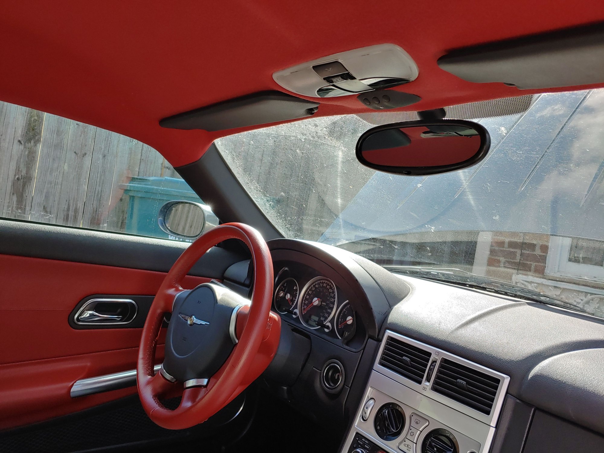

My turn signal problem turned out to be self inflicted. I had totally removed all the dash and console plastic panels for painting. I discovered that during reassembly, the Emergency Flasher wiring connector did not properly click into place. This caused an intermittent connection that would cause the turn signals to not operate at times. I properly seated the connector and now the turn signals work as they should.

The interior plastic panels were showing scuff marks and were looking worn. I changed the light gray to dark slate and used SEM Color Coat. I also took the liberty to introduce some Firethorn Red, also a SEM color.
