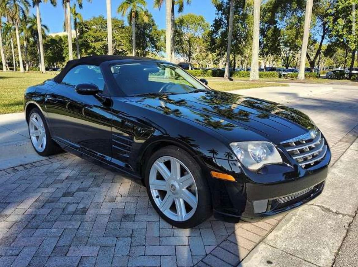

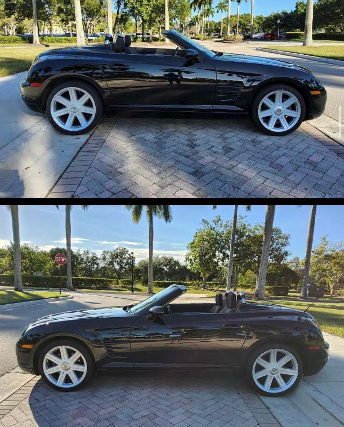

About to mod out this 06 NA 6speed Needing some help/confirmations on if y’all think this would work about to go full tilt on this car ahahha would like to make it all fit round 1
-Spring kit
https://eibachshop.com/index.php?p34...sler-crossfire
-Wheels
Vors wheels
Front 20x8.5 5x112 40mm
https://www.bbwheelsonline.com/vors-...-machine-35mm/
Vors wheels
Rear 20x9.5 5x112 35mm
Jnc wheels
https://www.bbwheelsonline.com/jnc-j...m-42613287628/
Jnc wheels
https://www.bbwheelsonline.com/jnc-j...0951313219661/
Tires
Front 225/30R20 Toyo proxes sport
Rear 255/30ZR20 Toyo Proxes Sport-Air intake
Needswings cold air intake
https://www.needswings.com/needswing...old-air-intake
images attached as of today 12/17/23

20 inch wheels will not work on the front. You do not have the clearance to turn.
If you lower the car you will need to configure suspension to adjust camber or be prepared to replace tires at 3,000 mi intervals.
Before you start spending money on this project, you need to do some more research on what you are trying to do and the consequences of your planned changes.
