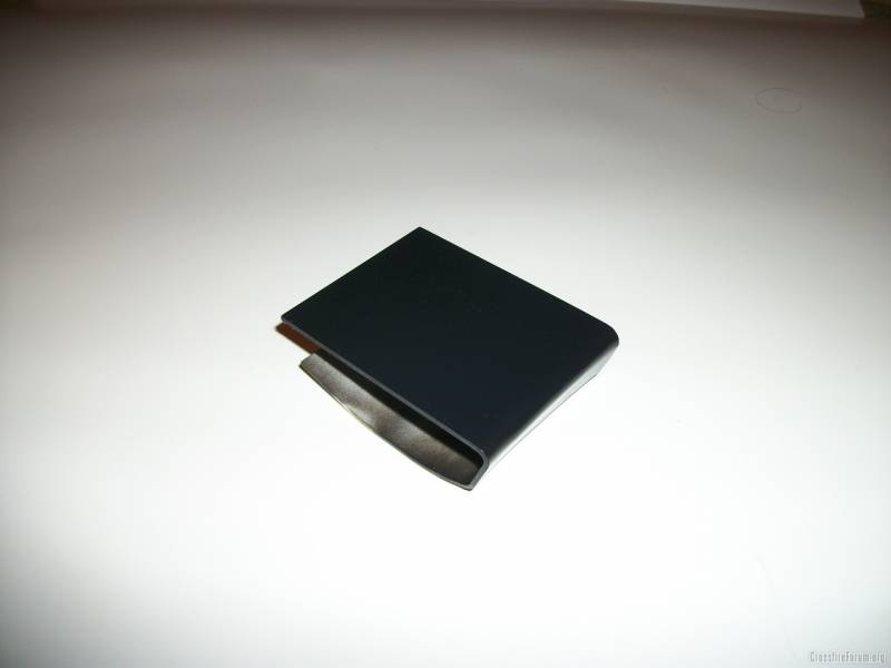

I do a bit of scale model building, so I grabbed a piece of fairly thick gauge styrene plastic
I had handy, and cut it into roughly the size I wanted. I just used a disposable lighter and a straightedge to bend the sheet of plastic to the glovebox's countours, and cut for clearance. (using the glovebox itself for referance)
After shaping, I painted it, and using an eyeglass chamois, I polished the surface a bit for maximum suction/adhesion
Here is the finished backside. it is partially unpainted because this is inside the glovebox and won't be seen, but also because I held it there to paint it.
And the topside

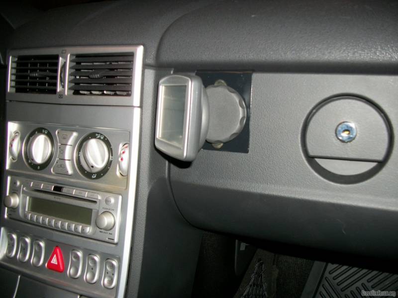

AND... here it is in the car. You can see how it contours the backside, but because it's plastic, it won't hurt the felt. I'm going to put little felt bumpers on the backside of the mount that touches the exterior of the glovebox door, to prevent any possible scuffing. Also, the glovebox remains 100% functional.
The angle isn't perfect, but you can esentially tell how it fits between the inside edge of the glovebox and the striker for the light. The rubber bumper helps to hold it securely too!
And here it is on the door. Nicely up and out of the passengers knees, and the useless little net on the passenger side of the trans tunnel holds the excess cord nicely.
And from the drivers POV, it blends right into the dash layout.
I'm verry happy overall. It's mounted now, we'll see if it's still hanging on when I leave for work later, and if it survives the trip, but so far so good.
