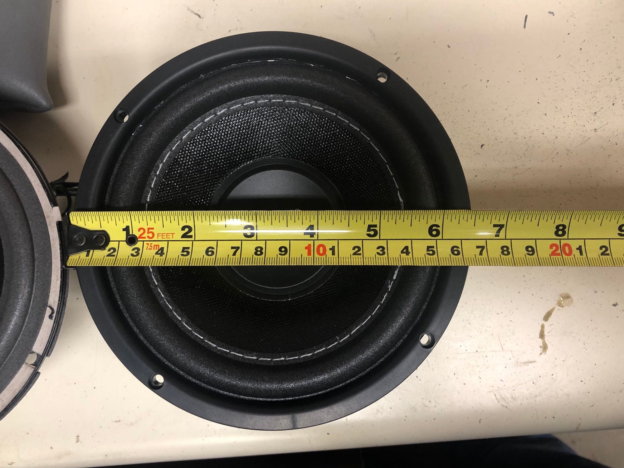

i just bought these and they measure 6.5”. Exactly the same as the stock speakers.
this photo shows stock speaker and Pyle speaker on next to each other. Exactly 6.5”.

Originally Posted by Tom3120
This is not correct....
Just measured mine and they too are the same size as yours. So not sure what the deal is.

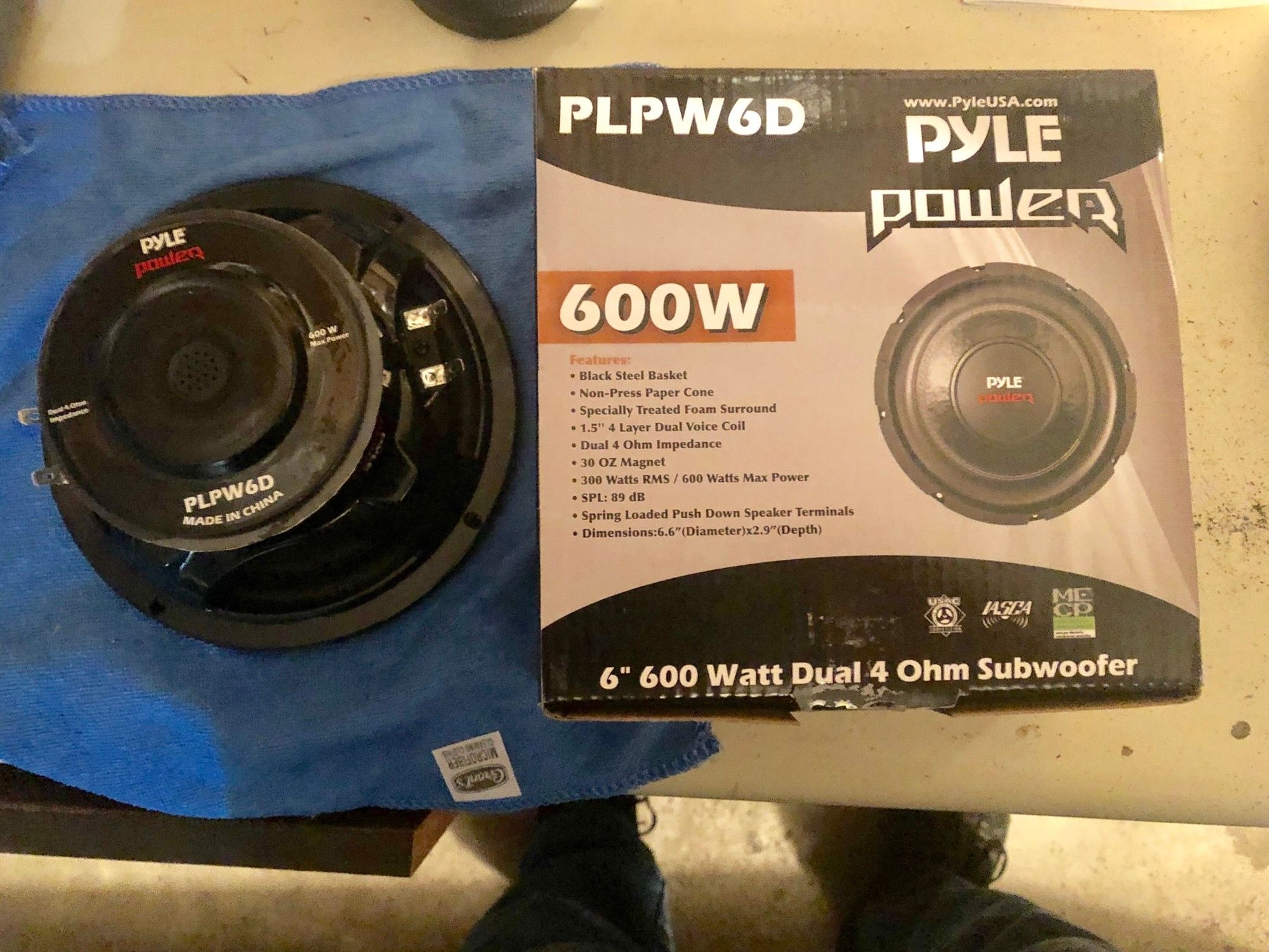

That is not correct.
The speaker is 6.6” diameter, it says so on the box and the tape shows the OEM is that.
The size is a nominal 6” diameter.

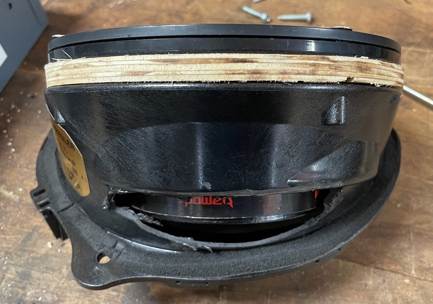

With some help I installed these yesterday
The thin wood ring was to be able to set the speaker flush in the basket
We were unable to dremel out the areas the speaker wouldn't clear in the basket because it was right where the screws needed to go to hold the speakers in the baskets
We used 1/2 inch plywood but I suggest only using 1/4 inch plywood if it works
The 1/2 inch plywood set the speaker up just high enough that when installing the speakers/baskets back into the bulkhead wall they were against the gas tank
Longer screws will also be needed to attach the speakers after this mod
Also note: The OEM speakers are not marked with + and - on the connections but the wider connectors are the + (Positive)
Red and Gray wires are + (Positive)
Green and Black wires are - (Negative)
