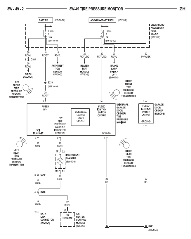

Is there a 12vdc switched by the ignition, circuit in the Dome Housing?

Pin 1 of the TPMS module is switched B+ on fuse #1, 5 amp, or pin 3 of the Garage Door Opener.
ok, i see that, radar hard wire coming up
thanks mr ala

I'm not sure which pin is #1
Can you tell from these photos?
Old May 17, 2017 | 03:10 PM
Default Re: 12vdc switched by the ignition in Dome Housing
it's the one with the pink/yellow/dark green wire
ok
i didn't realize that it had a connector further back in the cavity
it looks like switched 12vdc is available on the far right leg as you say
and ground would be the brown (3rd from right) ??? do ya think
Thanks
Old May 17, 2017 | 06:14 PM
Yes, as a rule, BROWN is ground on German cars, but you can always meter it be be sure.
yepp, brown/ground, i have forgotten more than i will ever know
thanks for the confirmation Ala
i'll throw a meter on it to be sure like you say, don't want to fry a brand new radenso xp,lol

ok, i nailed it, perfect
i used the Radar Mount hardwire with inline fuse and I built a mount as previously done in this Forum, modifying to my taste by making it just abit longer and powder coating it.
the RadarMount wire with gold plated pins worked real slick .. plug and play
thanks for your 2 cents mr Ala
