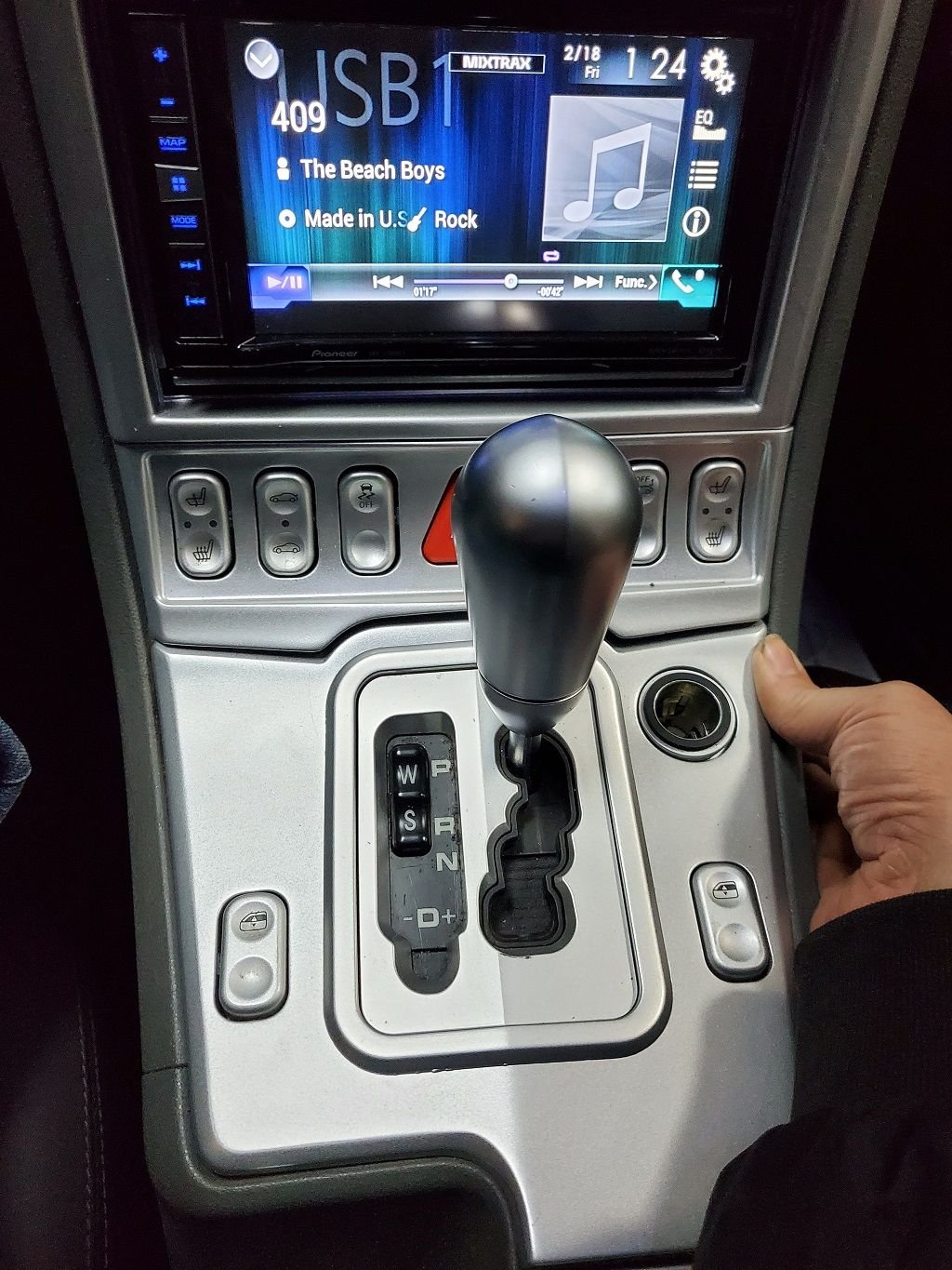

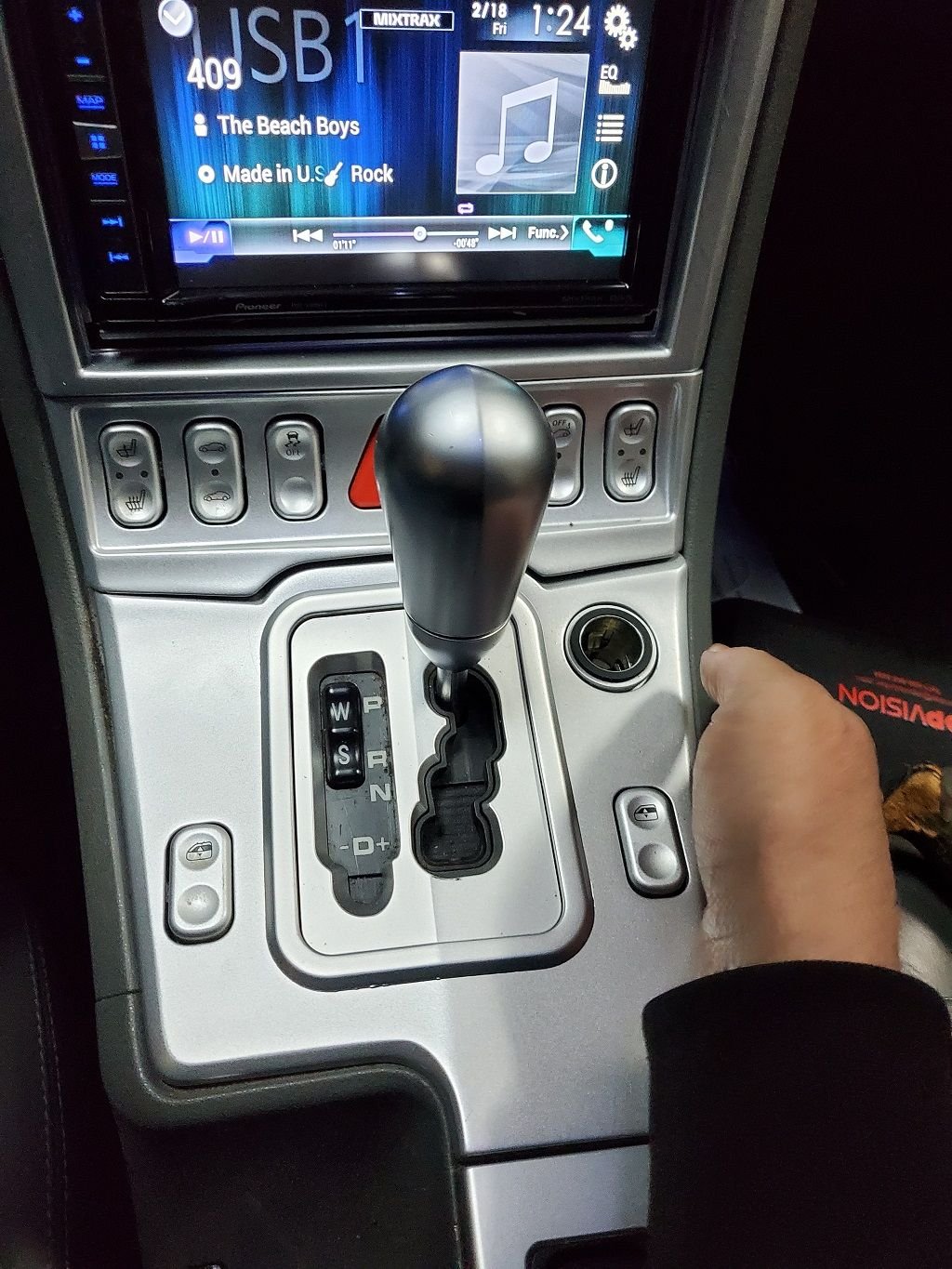

Well I finished the install. Still more pics to process and some other things I may tweak later but for the most part its done.
The reverse camera wire stuff I gave in and just tapped into the reverse wire for the passenger side taillight assembly. I noticed when I was tracing down the wires I wasn't but 3 feet from the wire coming from the tail lights so I just grabbed that wire.
I still have one problem to resolve and that one I think will be handled best by replacing the cigarette lighter housing with one that isn't as long as the factory one. I haven't seen anyone mention this but I noticed no matter what I did when installing the shifter console plate the cigarette lighter was cocked to the side some in the hole.
Also I noticed when looking at the pictures the plate is being pushed over too. The lighter is to long and is pressing against the shifter assembly itself. So I can replace the lighter with something shorter to keep if from touching or I can grind the shifter assembly. I think the lighter needs replacing
Here is what it looks like without being forced over.
This following pic shows the shifter plate being forced over to line up right.
Last but not least a shot of the stereo actually in the dash. Im waiting on the trim ring to get here to fill in the gap around the stereo.
