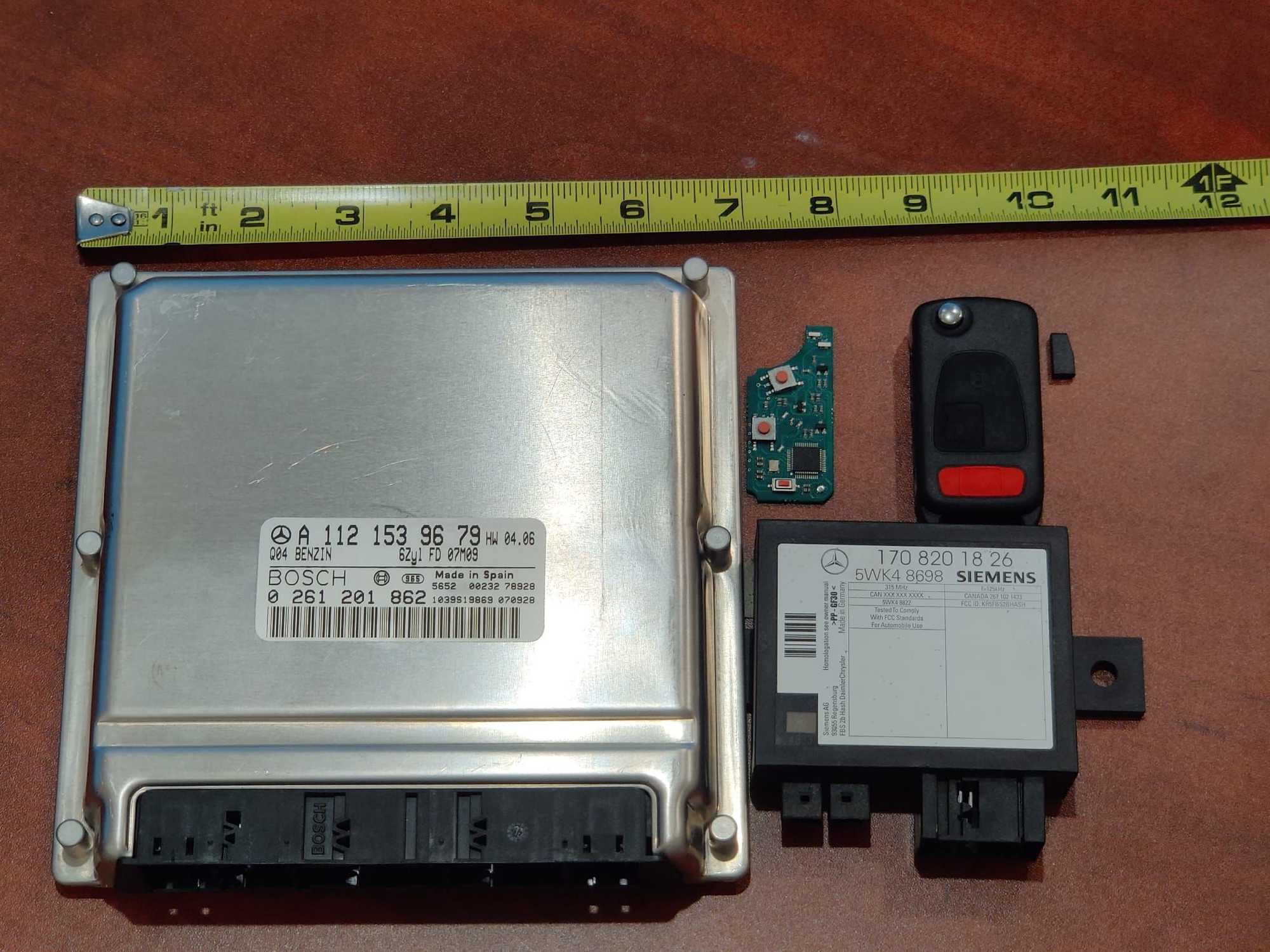

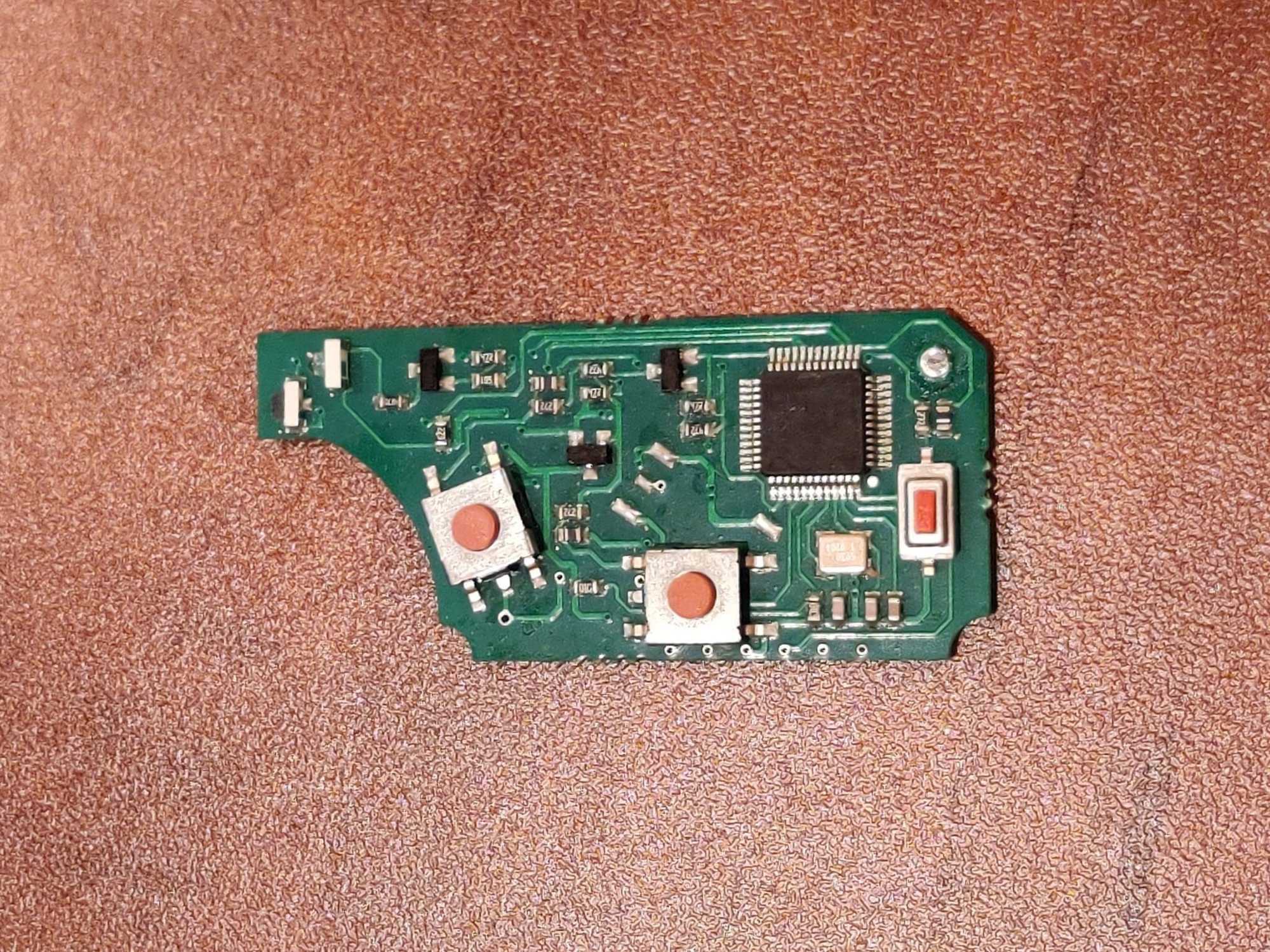

Prior to any retrofit, each key has a transponder chip and a transmitter. Those are separate parts! Transmitter is that little board, which you can see when you open the battery door. Transponder is an internal part, not connected to anything and is a black little thing positioned such as to bring it as close to the ignition as possible, when the key is inserted.
SKREEM, this is the name used for immobilizer box, black plastic box, located behind the instrument cluster of your vehicle, with 3 sets of wires going to it.
ECU - Engine computer, it is a metal box, located next to the battery of the vehicle, inside of that plastic electrical box and immediately next to RCM module.

When a button is pressed on a working key, the board transmits a radio signal, which is detected by the SKREEM. It is like a music which is transmitted by tower and received by your radio. SKREEM is looking for a specific transmission, such if you would be waiting to hear a specific song. Once it hears the signal, stored in it as "open door locks" command - it activates locks and doors are opened.

Making a key is easy. When all keys are lost and there is no chip or remote to based a calculation off, the data contained in the SKREEM is read. Using the date from the SKREEM a new key (chip and remote) is calculate, and programed. It is important to note that the vehicle can only communicate with a certain type of the chips, which is known as 7935 chips and can only hear waives at 315mhz. Using any chip, not compatible with 7935 or transmitter, which cannot operate in the same waives as SKREEM, will result in failure.
