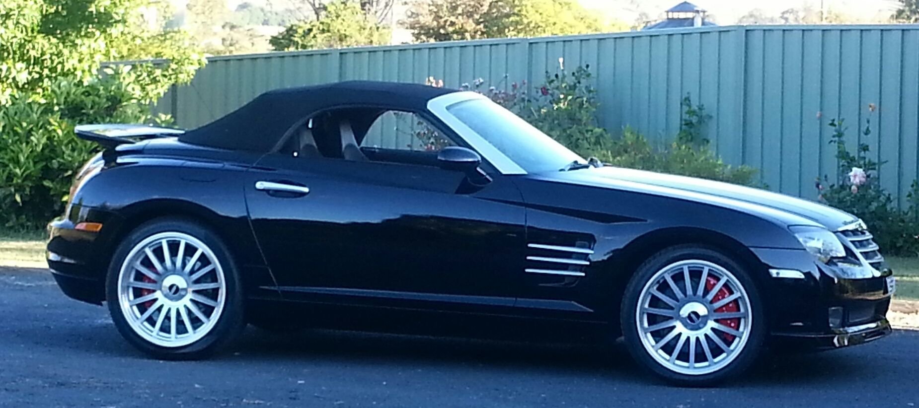

Heres my little beast, sorry about my phone pic,6 has the Groundcontrol kit fitted now,it will be a bit lower in a couple of weeks.

Old Feb 23, 2016 | 06:06 AM
Bodog's Avatar
Joined: May 2009
Posts: 133
From: Sydney, Australia
Default Re: a few upgrades to my srt-6
Nice!
She's looking good
Old Feb 23, 2016 | 06:35 AM
daveesrt6's Avatar
Joined: Nov 2015
Posts: 679
Likes: 10
From: Australia
Thanks !
she is motoring nice too :-)
Old Feb 23, 2016 | 07:58 AM
WindRestrictor's Avatar
Former Vendor
Joined: Oct 2009
Posts: 1,053
From: Dallas Texas USA
Looks in great condition.
