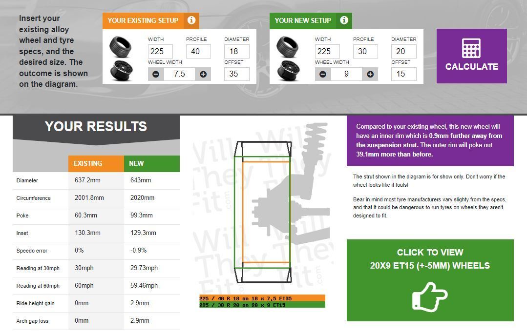

The new setup on the fronts show quite a bit of tire sticking out compared to OEM setup. I don't think I would use that but others more familiar with this hopefully will chime in.
A spacer of 10-15 mm would orient the install of the new wheel & tire much better.
Yes indeed, I'm quite aware of that yet just want to be on the safe side before mounting any tires. At the same time, I have informed the seller of the offset issue and hope they would revert with an amicable way out of this, since I'm in Europe and have ordered them from the US, on the one hand. On the other, we don't need spacers in this case rather more offset and less back space to push the rim inward and get it closer to the hub. Thanks again!
