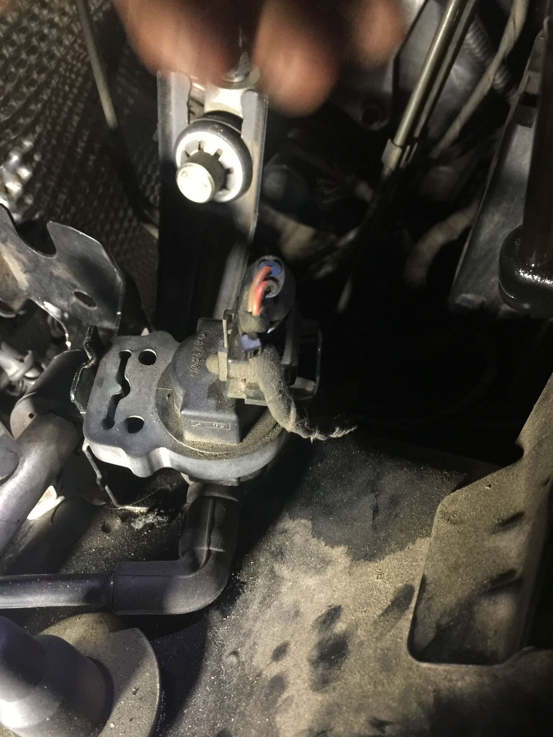

not to my knowledge although there was a little thing that goes on a clip to keep it from vibrating that was off.. (will try to include pic), but keep in mind the blinking gas light happens to other Crossfire users at half a tank too-unless these units go out frequently.. on this forum-and it seems a gas cap helped them.. See the clip to the left of the photo? It goes on that but was off when he pulled off the cover last night.. don't know if it has anything to do w it tho..
That is the part I was talking about.

Would it have malfunctioned from not being mounted on the clip? It drove fine to work this morning-it's a 65 mile drive so that's significant-on the way home last night the gas light blinked at least 3 times (I shut the engine off to reset it). Am going at lunch to have Auto Zone run the codes again in hopes it will reset then.. can u tell me what this part does? Thanks for your feedback btw!
Old Feb 14, 2017 | 09:40 AM
Default Re: blinking fuel light check engine
I'll save Dave some typing and answer this :
It is the evap purge solenoid.
The PTCM commands it to open the vacuum line to the fuel system upon engine startup to create a slight vacuum in the system.
The PTCM then monitors to see how long it takes for the system to return to ambient pressure.
If that time is shorter than it expects, then it decides that there must be a leak somewhere and flashes that light and sets that P code just to ruin your day.
( not too sure about it flashing the indicator, but I do know it sets the P code )
It is not a catastrophic condition, other than the EPA may arrest you for over polluting and lock you up for life + 100 years.
Old Feb 14, 2017 | 09:42 AM
Likes: 647
I believe that controls the EVAP system, nothing to do with the flashing light unless it monitors the EVAP system as well.
YOU ROCK! Thanks so much for this info!!!!!!! The humor was much appreciated too! It did kinda ruin my day when the light came on lol..
one more tiny question -do u think the unit off the clip it sits on would cause a problem? (Illustrated in the pic in the thread)?
good news is after putting it back and traveling back to work the check engine light has shut back off.. since I had a problem w the gas light blinking before the hubby carelessly knocked it off its seat I replaced the gas cap and put some 'Sea Foam' in the gas tank, so am not sure if reseating it helped or if the gas cap did, but after your wonderfully descriptive note I'm thinking reseating it did... your thoughts?
hapoy Valentine's Day btw!
So do u think it not being mounted correctly could cause the error code (P0455)?? I guess I'm just wanting reassurance it was caused by that-seems like it wouldn't have caused it just from not sitting correctly, but then again too much of a coincidence that that is what the entire function of it is, that's the code firing, corrected once seated back correctly..
Old Feb 14, 2017 | 04:12 PM
Likes: 647
Not caused by the unmounted state but a problem in the system somewhere.
are you sure? After re-mounting it the problem went away.. I also replaced the gas cap and added some 'sea foam' to the tank but the gas light was blinking the whole way home anyway after doing those two things-once I got home my husband re-mounted the selenoid, I didn't drive it til the next morning, after my hour and a halfback commute the check engine light went out.. in inclined to think re-mounting it fixed the problem, primarily because adding the new gas cap and the sea foam didn't affect a difference with the blinking gas light, or he check engine light, only after remounting it did those two things resolve themselves.. thank you so much for the feedback by the way!!

well, you were right it seems – on the way home the gaslight began to blank at the half way mark and the check engine light came on shortly there after… Stopped by AutoZone, and it's pulling the same P0455 code.

hoping replacing the purge valve fixes it!!
