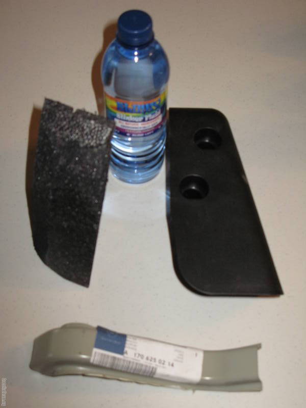

I just bought the three pieces necessary to add the dead pedal to my 2005 Crossfire.
5098567AA BRACKET-FOOT $17.30
68001751AA SVC KIT $24.80
68011616AA PAD-FOOT $40.35
I will write a tutorial as they are installed.

Is it adequate to attach the dead pedal with adhesive? The formymercedes site suggests that drilling could be dangerous since there are wires underneath.

I have also read about the dangers of drilling, but it appears the pedal in the 2007 is attached with a couple bolts. You might check with a dealer - they may have a diagram showing installation. Adhesive may work, but not on the carpet.
Suggestion: find out from the dealer if the pedal is secured by screws or nuts/bolts - then find someone with a 2007-08 and remove and measure. The reason I say nuts/bolts is I would be concerned that if the nut is not welded to the bottom of the panel it could fall off and be a bear to replace.
Possibly one of the other members has already bought and installed and can provide a better tip.

I took the black plastic dead pedal off my 2007 coupe to see how it was attached. Looks like they just cut holes in the plastic under the carpet and added metal clips to screw the two bolts into. The part numbers that I got directly off the part are different than those that were posted earlier. Looks like M-B part numbers.
Black Dead pedal:
A193 684 00 77
Two bolt covers:
A193 682 00 16
Looks like it would be simple to add, but you would probably need new floor mats.

Nope, still haven't installed it. I'm not sure everything is necessary, but I have it just in case.
