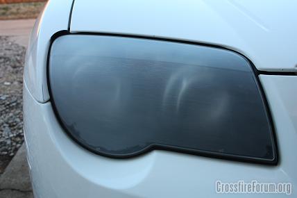

This is the headlights after wet sanding with 600 grit.
Then after wet sanding with 1500 grit

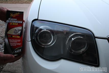

and This is what the box looks like.
This is some good stuff. hope i helped anyone with the same problem i can gladly said i HAD, not have.

Wow, that looks really nice. Will definitely keep this in mind if this happens to me in the future!

Only problem is it comes back and you will have to redo it. The Meguiars kit is a great kit. Another method is Meguiars Plastx and a buffer. That works equally as well with less elbow grease. Your head lights look beautiful, nice job.

Glad to hear this worked out so well for you. We just introduced this kit a few months ago and it's been a huge hit for us. I'm really happy to see you going the extra mile and wetsanding first then following with the kit to pull the sanding marks. Well done.
