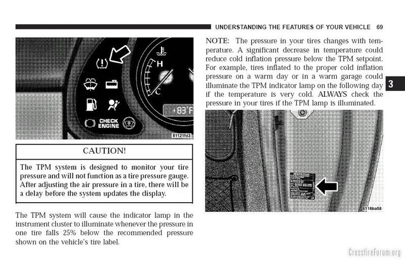

There is no code to reset. The TPMS just looks at the signal and if one of them shows more than x% difference, it sets the dash display. When the air is re-balanced the display will go out shortly afterwards. Mine will go on on very cold mornings and then go out after the tires warm up. Try setting the air the same in all wheels and see if it will clear. It SHOULD take at least a 3 or 4 pound difference to set the display.

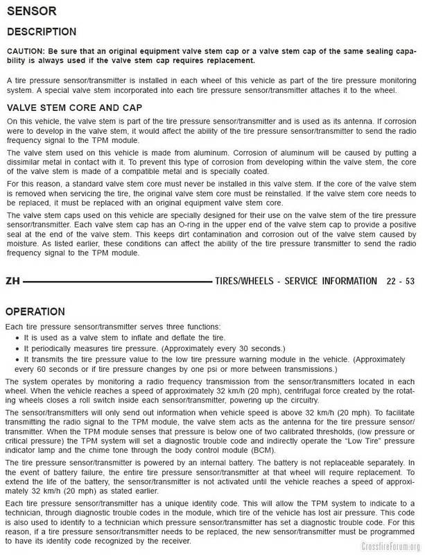

I have no expierence on the Crossfire yet, but on Ford you have to drive the car 20 mph before the light will cancel after you correct the tire pressure. The sensors only transmit a signal over 20 mph to save on battery life when the car is sitting still.

If you do have a transmitter (sensor) problem, you need a DRB3 tool and a calibration magnet tool to figure it out. Unfortunately for me that would be "dealer time" since I don't own either of the tools.

All good points, but did you check your tire pressure when the tires were hot? The sensor will alert you if the tires are off by 10%. So if you checked them when the tires were hot, that might be your difference. Make sure you check then when they are cold.

I can tell you that my indicator will come on right after winter storage. When I check the pressure it's at about 30 lbs. Once I inflate them properly, the indicator goes.
Yes the pressure was checked when cold. The sensors are supposed to activate a warning when pressure drops 25%. At 33psi, that is 26psi. Knowing that pressure increases and descreases as temperatures change, a 25% difference is a lot. My point being that unless you ignore your pressure and let your tires drop to 26psi, you should never see that warning icon. I'm guessing one of the sensors is faulty.

FYI - The service manual states that if you get a DTC (Diagnostic Trouble Code) for a transmitter low battery, the sensor must be replaced. Says nothing about changing out batteries.

From the on-line service manual...

Battery life is expected to be 7 to 10 years, that is what the industry standard is. The units are installed like a regular valve before the tire is installed.
Was anything done prior to the light coming on? If you have had tires fitted and the light came on at that time I would suspect that a unit was damaged during the installation of one of the tires.
How these things work is a mystery to me, I know they transmit a signal and are tied into the garage door opener transmitter.
