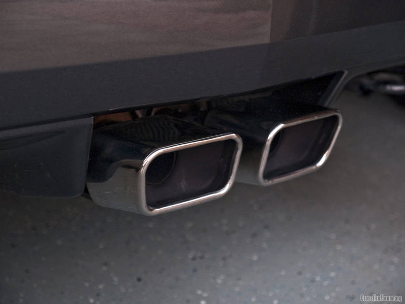

Why do I have to clean my rims every two weeks from break dust?
How do i get the black off my exhaust tips?

Clean you exhaust tips with Nevr-Dull available at most auto stores and Walmart.

Paint the inside tips black, then your cleaning is cut in half!

But it looks awesome when you look at your tailpipes and their shiny inside.
I second the never dull, it's a lot of work the first time, but it's easier to maintain.

For polishing exhaust tips, get a Mother's power ball (mini). Chuck it in a drill, rub on some never dull and presto, instant clean pipes.
