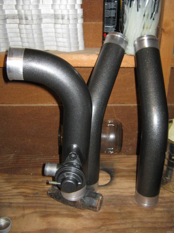

Here is a little of what I have been up to.

The paint I used on the IC pipes is awesome. It has tones that go very well with the SSB paint. I plan on using it throughout the build. I'll post some more pics tomorrow with everything back together.

Pipes look awsome. I can turn a wrench with the best of them, but i went up to Steve's (32krazy!) to get my springs cut and camber kit put on. He has all the specialty tools that make the job a whole lot easier. cheers
What paint is that? Looks great!

Didn't get everything done but close. Ended up wasting a bunch of time trying to find the right o-ring for the transmission dip stick tube. The intake manifold and timing cover are next in line for paint. The paint is a Fusion color, I'll look for the exact name next time I'm in the store.
