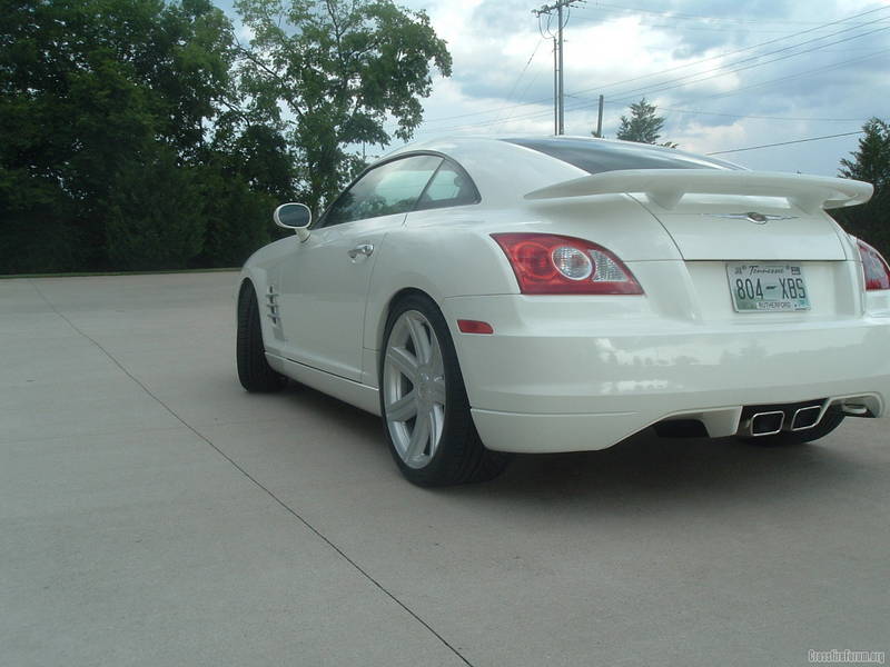

Here's a picture of mine with the Eibach's and dot 1 pads on the rear and dot 5 pads on the front.
Les

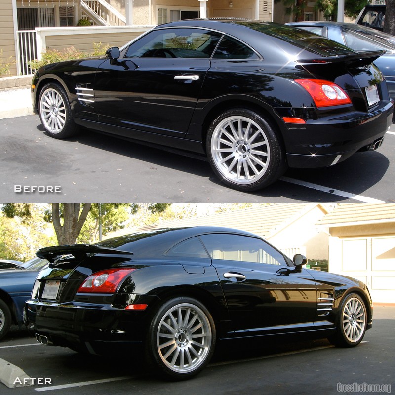

Here's my comparison. I installed these with the thinnest spring pads (1 dots both front & rear).
This is the exact stance I'm looking for, where can I get those pads and how much?
