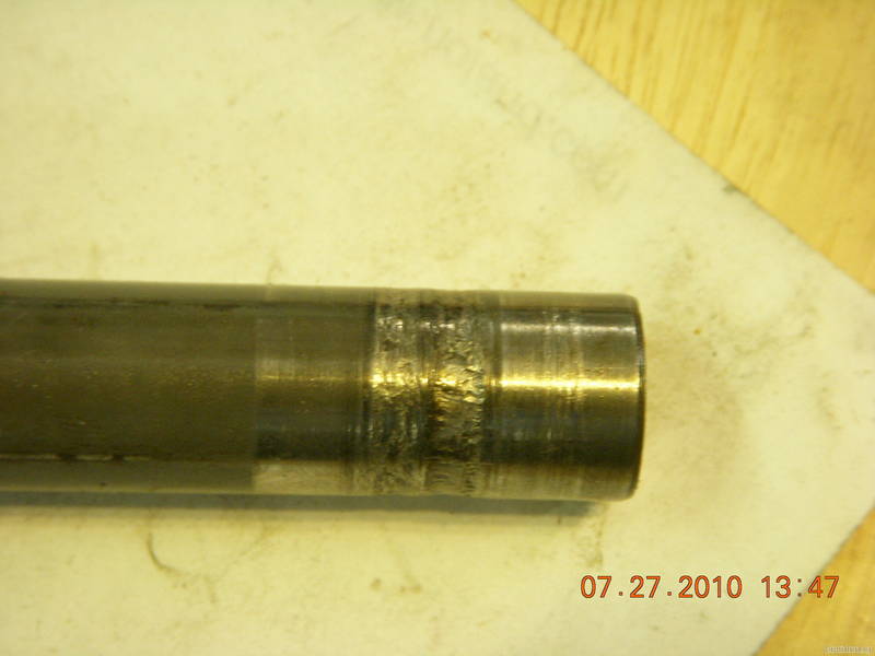

Have you been doing drag racing or hard driving? Id really love to see any photos of your differential and hear about details relating to the failure cause or part loss.
THe SRT rear that I examined had the spider gears gaul the pin and shear the retention pin. The pin has a flat side on it that allows lubrication to enter the spider gear / pin area. Please see the photo of the endo of the pin in the differential case.
I believe that the use of synthetic oil in the differential can reduce the incidence to gaul the metal surfaces. Synthetics are stable and do not charr as easily as standard oil. I used synthetic rear lube at the factory recommended viscosity, and I believe that it was something like 75/90 weight, though I cant be sure without checking the books.
Your problem finding a rear is very understandable and you might consider the 1100$ wavetec differential carrier as an alternate to the factory rear. We are all going to have to consider where parts come from if the factory can not supply them. THats why I switched to supporting the diff buy and put my credit car down to secure one.
Woody, please let us know the problem with your rear, carrier bearings, spiders, axle gears or ring and pinion. Thanks.
https://www.crossfireforum.org/galle.../DSCN30941.JPG
Pin end showing the oil passage ( flat area) that lubes the spiders and PIN.
https://www.crossfireforum.org/galle...m/DSCN3098.JPG
Gaulled pin that holds and twists the spiders in the rear. Note that wear is on the outer end of the pin due to deformation of the pin under loading against the spider gear.
I do not know of one oil for the diff. over though others will have data to share. Woody

THat could be carrier bearing, the big bearings that are on the side or end of the carrier. Does the noise change when you make VERY SLIGHT left or right steering corrections while maintaining a constant load / speed of flat grades?
THat changes the side loading and thus the possible tone of the rear noise pointing to the big external carrier bearings. https://www.crossfireforum.org/galle.../DSCN31082.JPG
IF you jack the rear up safely and run up the wheel speed you should hear the noise if it is wheel bearings. Safety is left to the student to maintain in this adventure, and you lose points on the exam if you get under a running car!!!!!!!!! If you have survived that one, the wheel bearings are just inboard of the brake rotors....and your spotter / assistant may be able to hear which one/side is snafu.
Speaking of inboard do you know what POSH is all about??? Unrelated ditty, POSH is an abbreviation for PORT OUT and STARBOARD HOME, in the atlantic it puts your cabin on the shady side of the ocean liner ........Now thats good for the water cooler quiz fest tomorrow.
Having fun Woody
