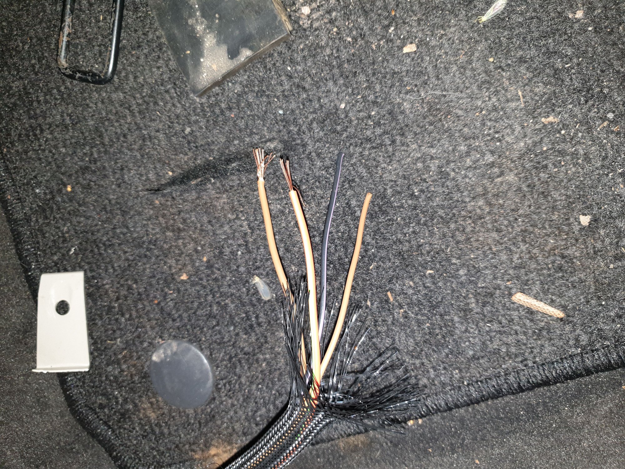

I am trying to wire the installed seats in the car i bought 4 month ago.
But i need a little guidence to sort it out.
I have taken some photos from both passanger side and driver side of the wiring that is loose.
Here is photo of driver side:
The one with 4 cables comes from the car under the carpet. And the 8 cables is coming from car seat. The 4 smaller cables matches the 4 small cables coming from driver seat.
Another photo that helps you see colours of cables.
Here is photos of passenger seat:
This is coming from the car seat.
Same wires as above. Just to see colours of cable.
This is coming from under carpet and is connected to car seat. Dont know it is connected right????

Ok. Ive figured out which is the power to the seats . It is the red/green and brown wire.
I also connected all the smaller wires.
I only have 2 wires left i dont know where to connect or what they are used for.
Here is photo of which ones i dont know where to wire
The red/green is for seat motor. And there is one black and brown left. What are they for and where to connect???

I believe they are for the seat belt switch.
Thank you. But are you sure about it?
Both seats have this cables.
One i black and purple
Other i brown
Old May 2, 2019 | 06:33 AM
DavieBoiii's Avatar
Joined: Dec 2018
Posts: 23
From: Sweden
Default Re: Installing srt-6 seats. Dont know wiring.
Found this wiring schematics. Think it is the right one. And the cables are for the heater.
I need to wire blavk/purple to the heater controller behind dashboar i think.
Can i then just ground the brown?? Or do it also need to be connected to the heayer console behind dash??
