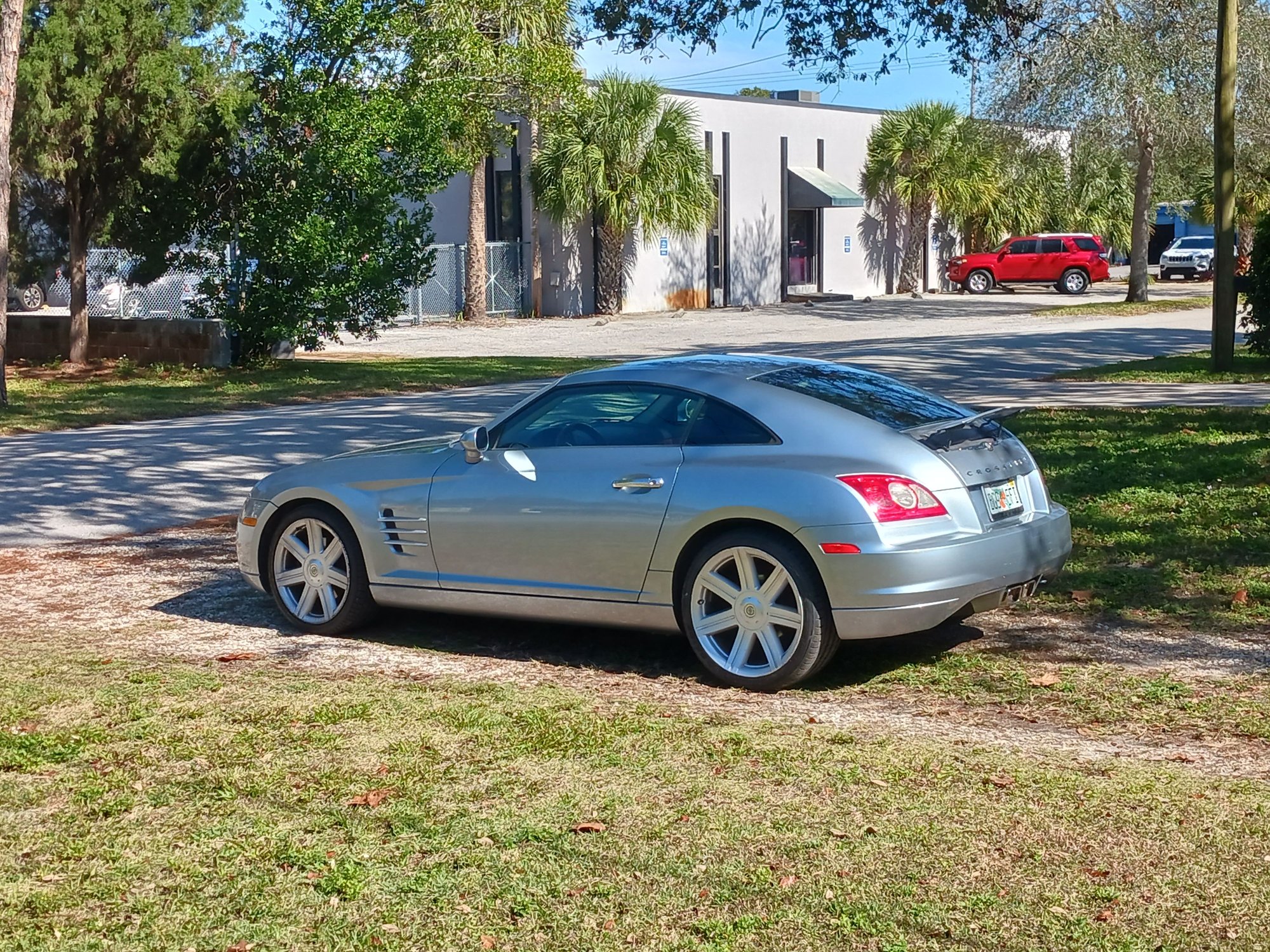

Anyone that has been following my several postings will find this just one more problem to be resolved. I bought this '05 Xfire about 6 weeks ago and have has sooooo many problems trying to get it on the road being dependable. That being said, the car really runs sweet with 11k miles. Here is a list of my other problems still being dealt with.
1. Intermittent "no start" SKREEM (Sending to MSS when I get a chance to remove)
2. Drivers side catalytic converter factory weld has split about 6"
3. Passenger side headlight won't adjust properly
4. The airfoil wing needs painting
5. Radio needs replacing and works sometimes
6. Bad curb rash on all four wheels
7. Seat relay needed replacing and now works fine (replaced)
8. Broken dash bezel had to be epoxy back together (done)
9. Steering damper worn out. (replaced)
10. Rear tires dry rotted (replaced)
11. Splash shield missing and will be bad on exposed alternater
