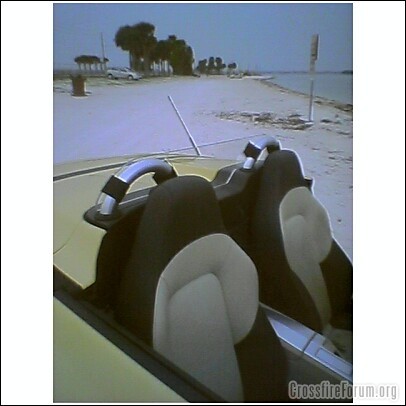

I just installed mine and hands down, a major improvement when the windows are up. To give you an idea on the type of improvement - I've talked to people on the cell with the top down and the windows up and they've told me they could not tell I was riding around 'topless' (until a motorcycle or semi would come by) - so thats gotta tell you something. And like Stacy said, it allows for a woman with long hair to arrive not looking AS discheveled and she would when there is no windscreen (hey, VERY important guys!). However, when the windows are down, well, there's really not much of a difference from not having a windscreen - the wind is still going to blow - which is the point in having the top down in the first place, right??
Outside of all of that, I personally think it adds something to the already sleek look of the car. For some reason, it seems to make it classier looking.
