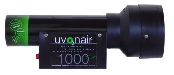

Ozone. Has anyone had any success? I called a local detail shop and they do not perform an ozone treatment. I saw a suggestion tho use the Uvonair 1000 Junior on a detailers website. The $185 price seems reasonable especially considering I could also use it in the future.
http://ecx.images-amazon.com/images/I/31NBH7MSXZL.jpg
