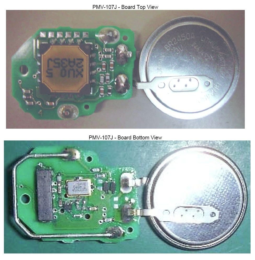

I would LOVE a 'visual' view of the TPMS sensors sans the 'polymer' or whatever it is. How was it removed, what does it look like inside that housing. It's nice to orally describe it but a picture with oral would be complete. I have yet to 'see' any of the sensors opened up.

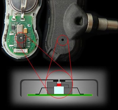

Ask and you shall receive
Lots of pictures, just Google tire pressure sensor diagram.

Dave, is this our (one of) the TPMS on the XF's? That housing looks nothing like the housing on mine BUT there are (I believe) two different OEM versions. I should get un-lazy, and post a picture of the 4 I took off mine when the battery on one of em started failing. Come to think of it, it seems now there are a few aftermarket ones that are reported to work as well (manufacturers knew there would be a market for undercutting dealership service departments huh).
If it were possible to open them (mine) up, I bet it would be quite the effort and problem, to find/replace that battery (including making sure the connection was 100% fault free/corrosion resistant). Remember also, the pressure transducer must not be damaged or plugged up/blocked in any way after re-sealing the thing. Thanks Dave, for the pictures! I believe this is the first time I have ever seen a 'cleaned' TPMS board in its entirety!

I cannot say they are the ones in some Crossfires, about the correct shape though.
There were two makers for our TPMS, Schrader and Siemens. Are yours Siemens?
