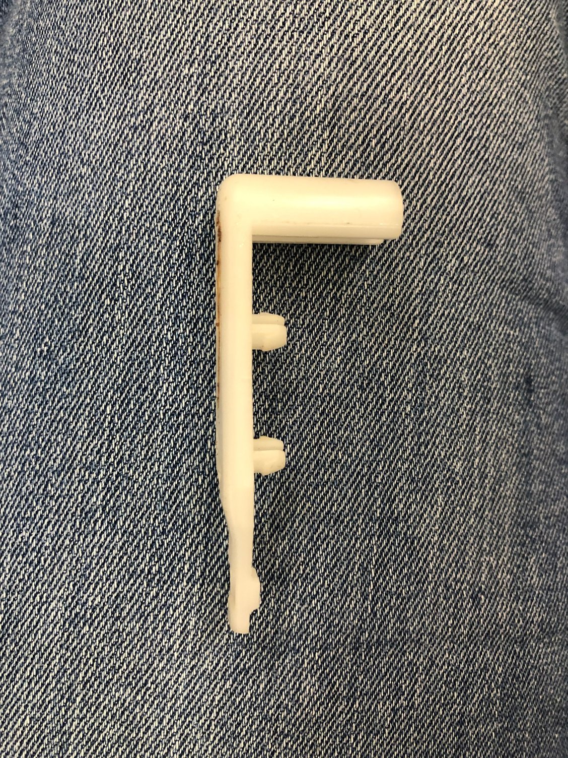

I have a 2006 roadster that until recently the top was working fine. Now when I release the top, the windows go down and I hear the motor working but the back of the top wont release from the back top of the trunk. I also found a small white plastic piece in the trunk. Ive taken it to two places already and no one can seem to help, including the Chrysler dealership. I love the car but Im about at the point where Im ready to get rid of it over this.

Was able to unlock it and it did release and start to go up but struggled. Didnt open to begin storing the top and then didnt want to close. Could it be the actuators? Also, do you happen to know where the plastic piece in my original post goes?
