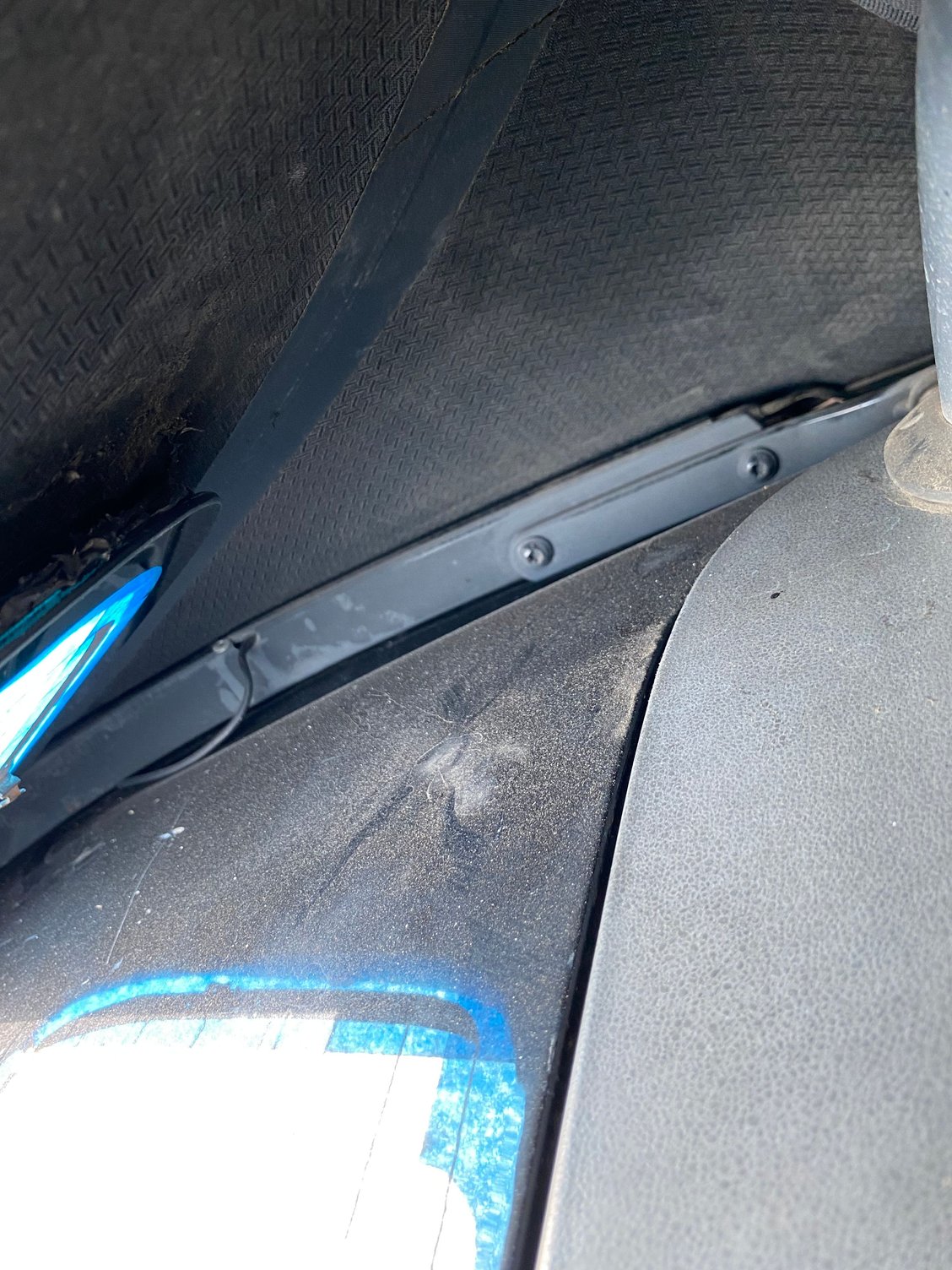

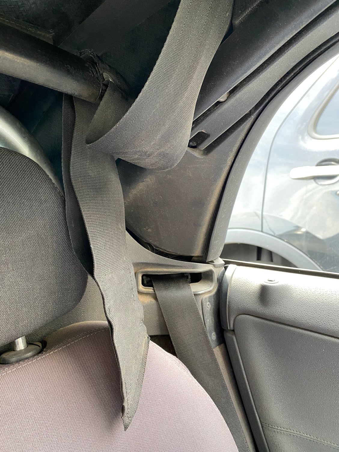

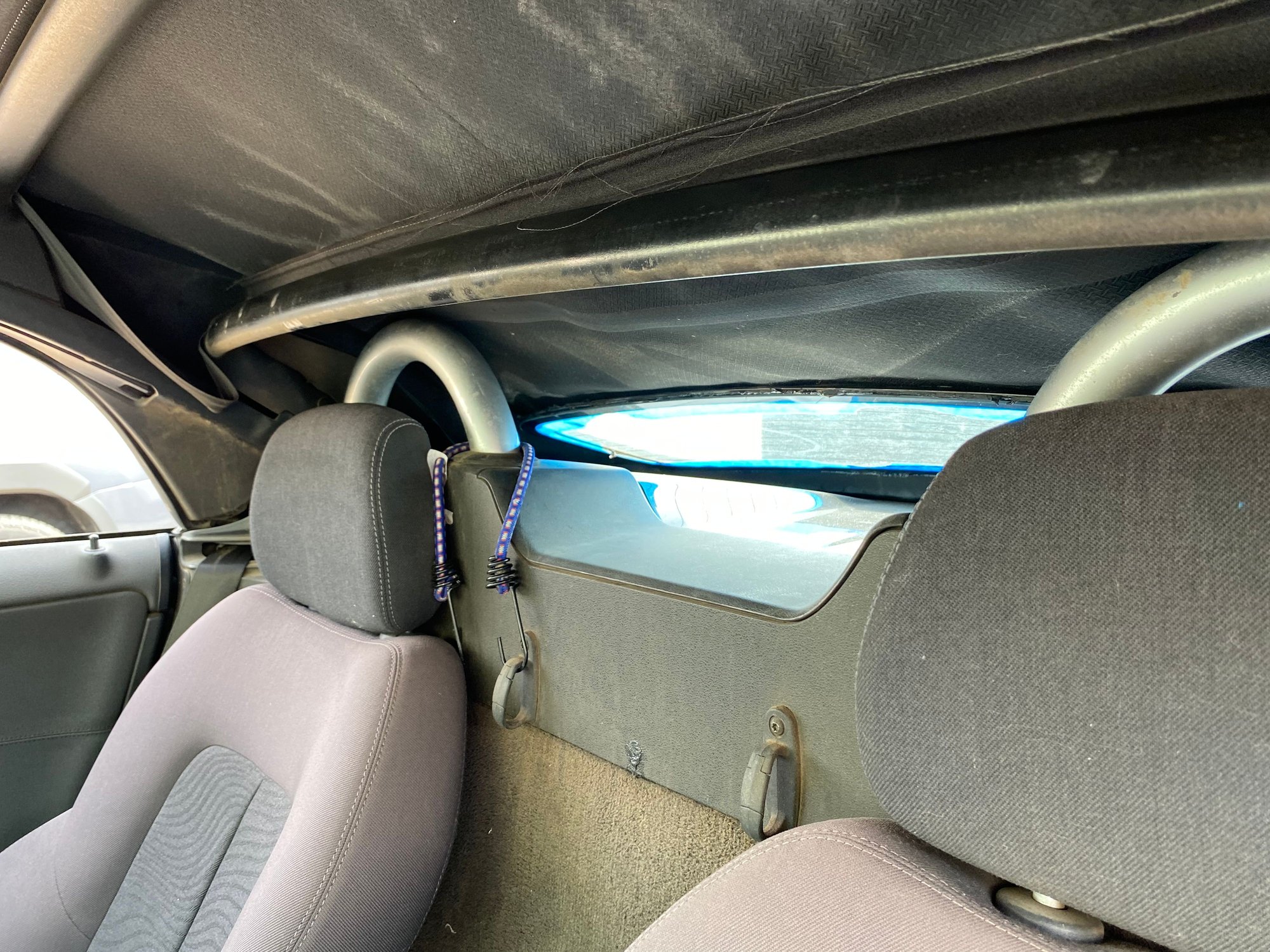

Some not very good photos. Seems like this strap should be attached to something?
Old Mar 28, 2024 | 07:07 PM
Posts: 13,965
Likes: 1,293
Default Re: Rear top bow on the loose?
I have notified a few experts who might be able to help. I cant even think of what those straps are called. But I do know that if you order a new top, they do not come with the new top.

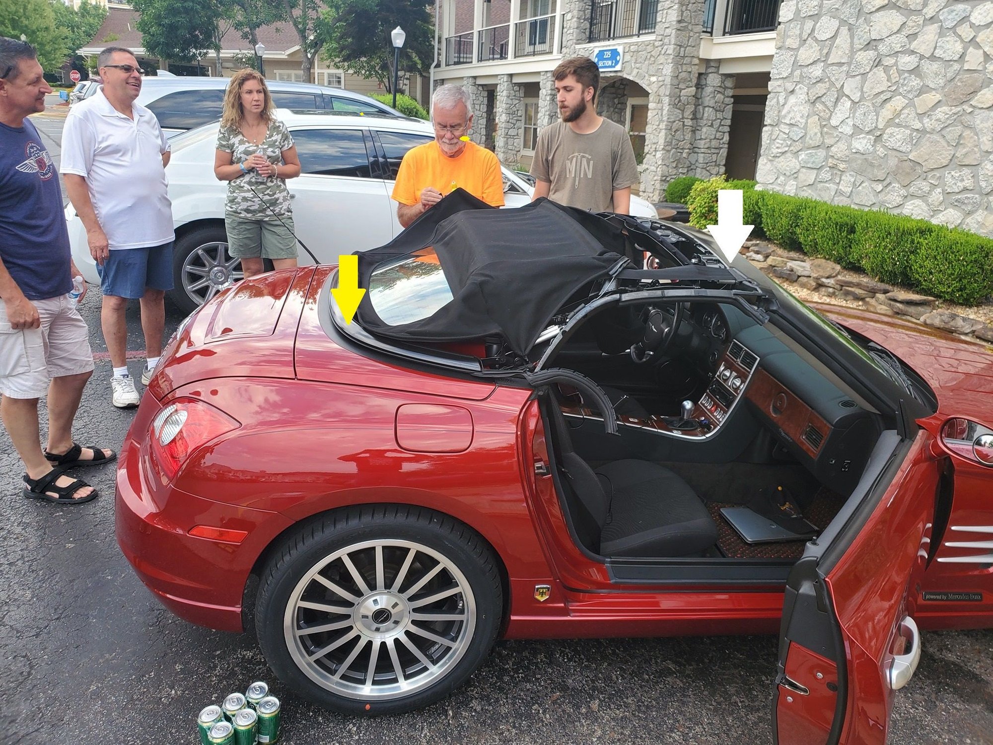

Can anyone post a pic of what the rear of the straps are supposed to be anchored to? Thanks
You won't get a photo from me, as my phone refuses to operate it's flash.
The straps go from the headliner frame (white arrow) to the rear bow (yellow arrow). The straps are part of the top MECHANISM, you can see one in the picture below, as Zach and Bob replaced my top at the Eureka meet in 2020.
THe top itself is just the fabric and glued-in glass.

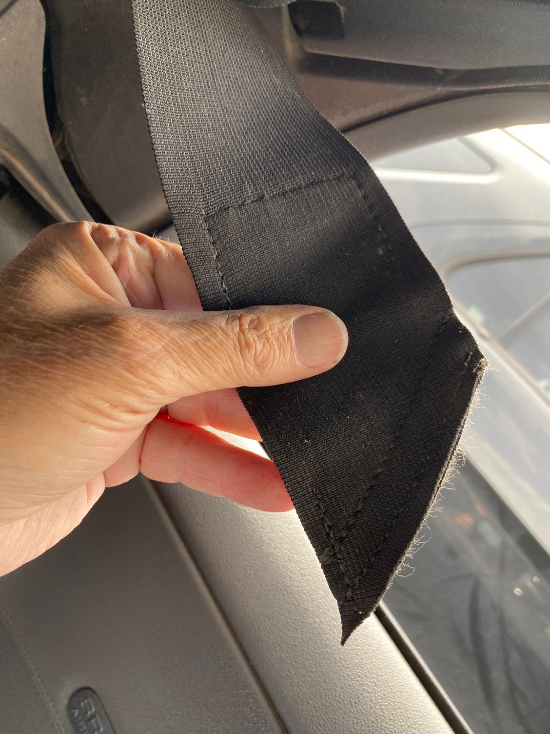

Old Mar 29, 2024 | 07:16 PM
No704's Avatar
Joined: May 2019
Posts: 183
Likes: 27
From: Tempe
Thanks everyone! I’m just not sure they didn’t pull out of the attachment point as they still have what appears to be a nice sewn end on them.
