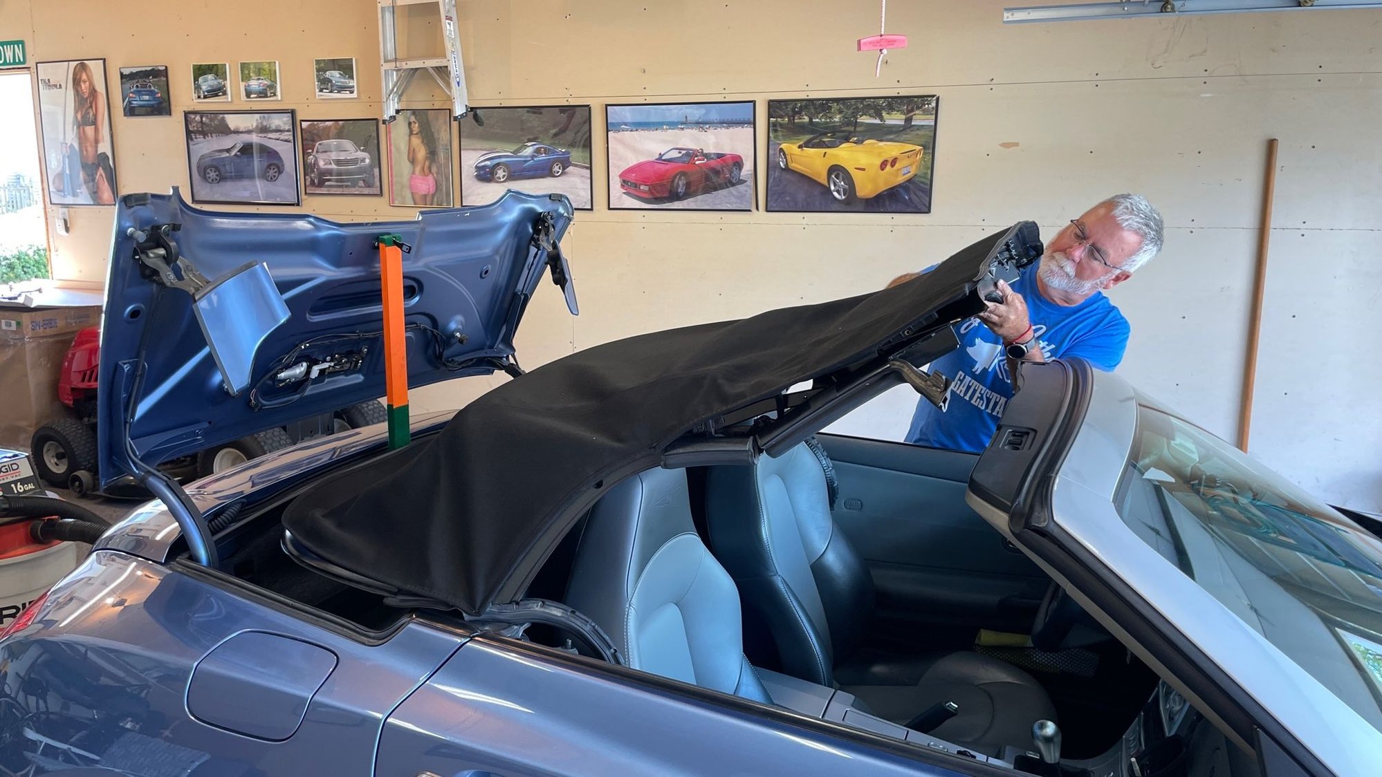

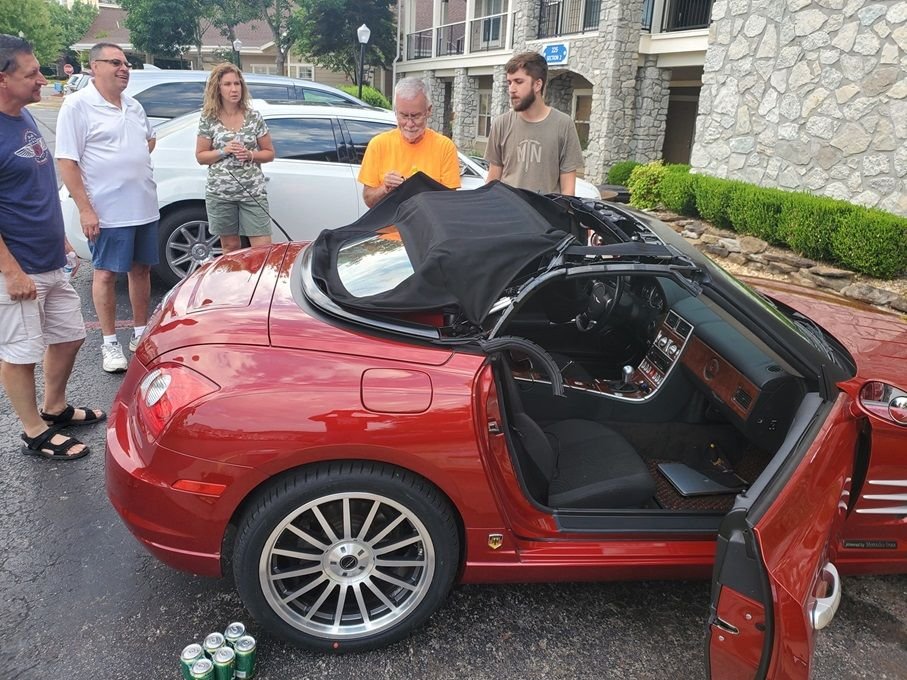

Lovin' my new top - some really good friends replaced mine for me at the Eureaka meet, one morning before breakfast.

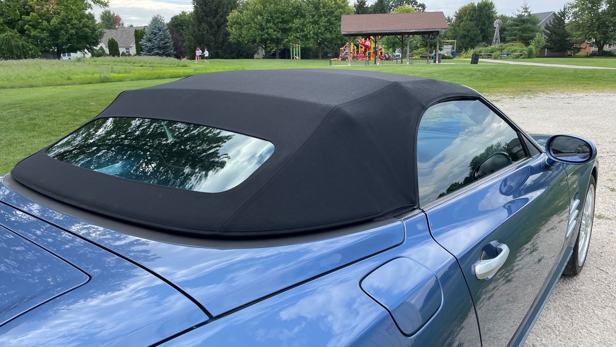

Love my new BAS top too and it was installed in August 2023 right at my house by the same guy seen here who installed Pizzaguy top
