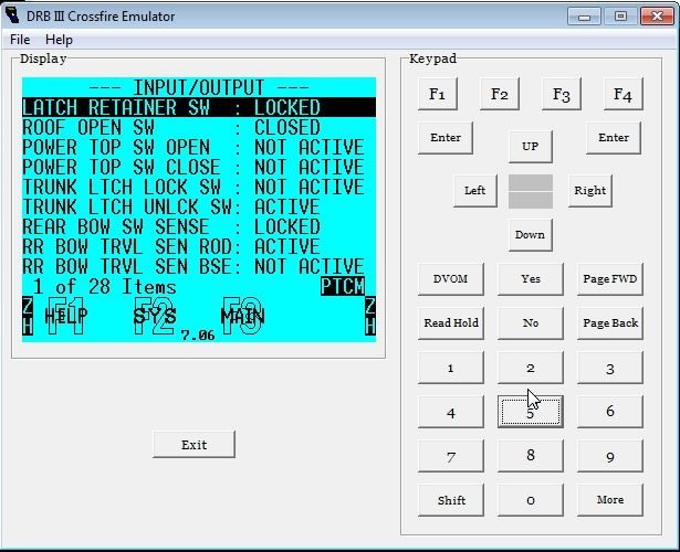

Hi all. I feel like this would be very simple if I knew exactly what to look for... Convertible roof won't open or close or otherwise move. Rather than detail all of my tests - I can say that I have gotten as far as confirming the divider switches are not the issue by following this step-by-step guide:
Convertible Top Sensors - CrossfireForum - The Chrysler Crossfire and SRT6 Resource
I am using the DRB III emulator to run some tests, but I really don't know what I am doing. Here are two screen shots that I took as I ran the tests. There are no Power top codes that I could find.
This surprised me. I think I need to learn how to use the tool better. Any suggestions on how to use the DRB III to pinpoint the exact issue with the top would be most welcome.

Old Dec 18, 2024 | 01:39 PM
Jaminmon's Avatar
Joined: Jul 2024
Posts: 9
From: NJ
Default Re: DRB III - trying to troubleshoot convertible issue
ZERACER - Does the DRB reporting it as closed mean it could be the problem? I would think that would suggest it's not the issue.
Still learning how to use that tool.

Sorry, I'm not versed in the DRB3. Do the readings change when the top is latched and unlatched? That would indicate it is working.
Here is a link to a great thread by pizzaguy.
He shows where all of the sensors are located and trouble shooting techniques.
Convertible top sensors
