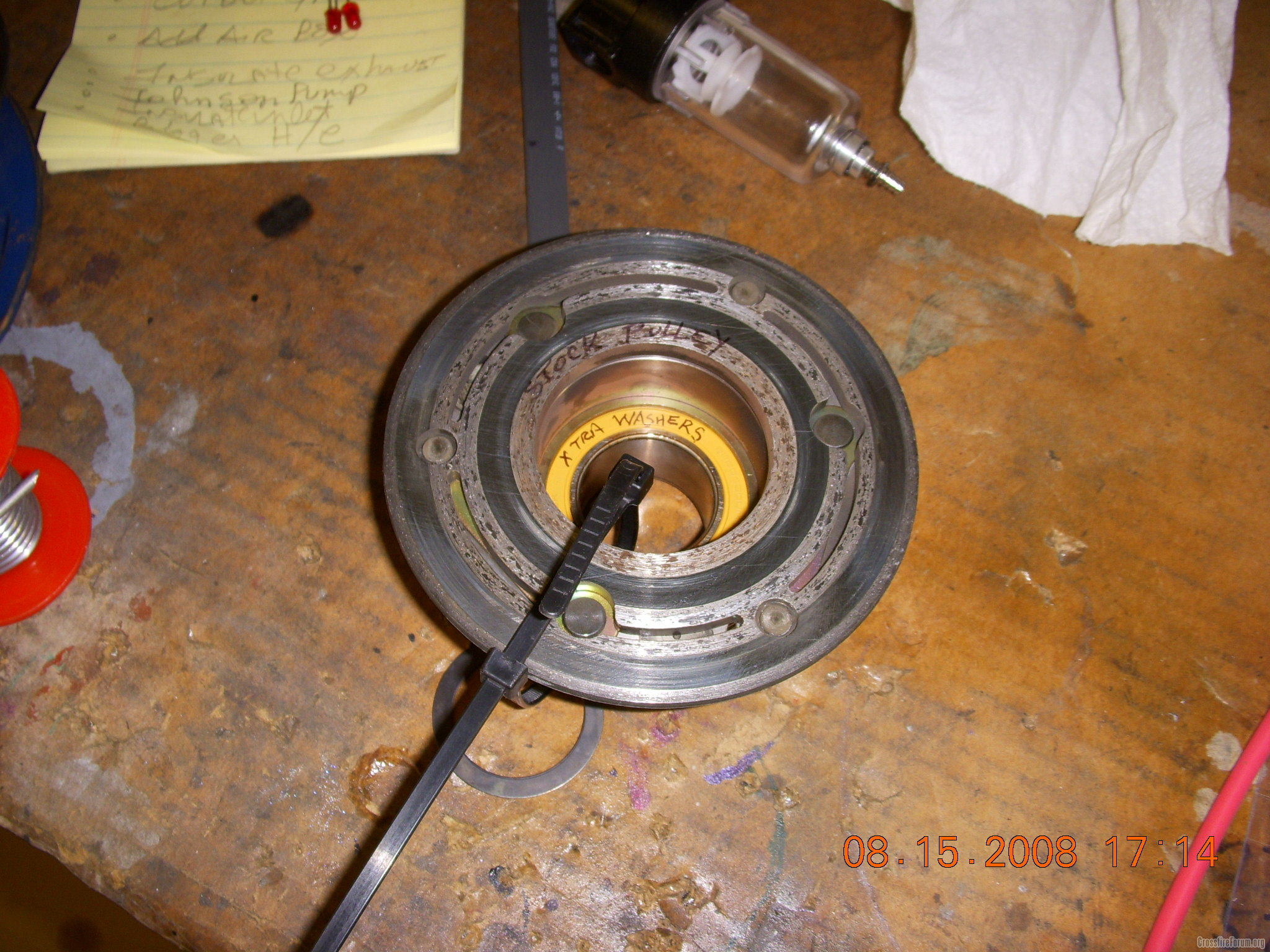

BTW the pulley can be removed c/o the Code three instruction, if you are into the garage and such. THis would allow you to see if the clutch surface is worn out. Ill try to post a photo of my pulley ( not the clutch face, the opposite-pulley side) for your info. Its smallish and there fore puney (spelling?)
