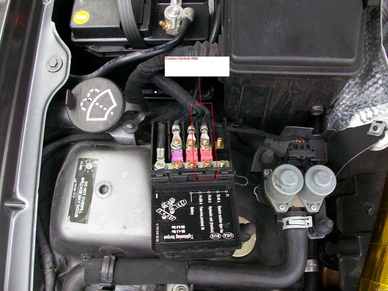

This is the location of the wire for traction control this little fuse box is in front of the battery
