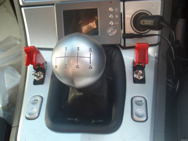

Well I got the remote control circuit to turn off fuse's 17 & 18 installed this weekend. I had never pulled those fuse's in my car, all I knew about pulling them is what I had read here on the forum. It works good, just a click of a key fob and they are off and another click and they are on. I'm going to try to post up a couple pic's, one is the circuit wired up laying on a bench with the relay's tie-wrapped together and a thin piece of rubber wrapped around them to protect the connections. There is also a 4"X4"X2" thick piece of what looks like carpet padding in the same picture, it was laying in the very bottom of the fuse box. That is where I set the relay's & fuse holders, the remote reciever I pushed up between two wiring harness's that go on into the cabin (fit like a glove). The only wire that is outside the fuse box is the ground and I hid it pretty good. When I went out for a test drive I turned off the fuses and the ABS & BAS-ESP lights came on. I put it in 1st gear ran it up to about 10 MPH and while watching the tach I nailed it, I got pretty sideways immediately, the tac went up to about 6,200 & shifted to 2nd. Then I went looking for a parking lot with no cars to try a doughnut, found one at the local VFW and gave it a shot. It started out good, but once it started around and got a lot of weight on the outside rear tire it quit spinning, I was very disappointed, I only tried once because I didn't know where the town cop was.

My brake lights worked only when the key was on before I done this mod. The relay's I installed are normally closed so it's just like OEM until I click the remote fob and it's just like pulling #17 & #18 fuses. I had read awhile back that someone said their brake light didn't work when they pulled those fuses, so I went out and checked them with the circuit open and the brake lights still worked. I noticed right after I bought the car new that the brake lights didn't work without the key on. The Crossfires are the only car I've ever seen that the key had to be on for the brake lights to work.
